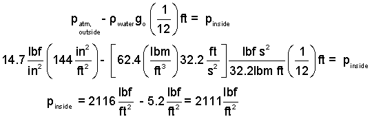

♦ First we must determine the pressure inside the building. To proceed we must know the pressure somewhere. It is logical to assume the outside pressure to be standard atmosphere. Thus the pressure of the air at "A" (just above the water in the right leg) is one atmosphere. The pressure at "A" but just under the water surface is also one atmosphere. The pressure of the water in the left leg at the level "A" is also one atmosphere. Finally, the pressure of the water (and air) at level "B" in the left leg is less than at level "A" by "one inch of water." We write and solve the hydrostatic equation:
Equation (1): p_atm,outside − ρ_water g_o (1/12) ft = p_inside; 14.7 (lbf/in²)(144 in²/ft²) − [62.4 (lbm/ft³) 32.2 (ft/s²)] (lbf s² / 32.2 lbm ft)(1/12) ft = p_inside; p_inside = 2116 lbf/ft² − 5.2 lbf/ft² = 2111 lbf/ft²
(1)1

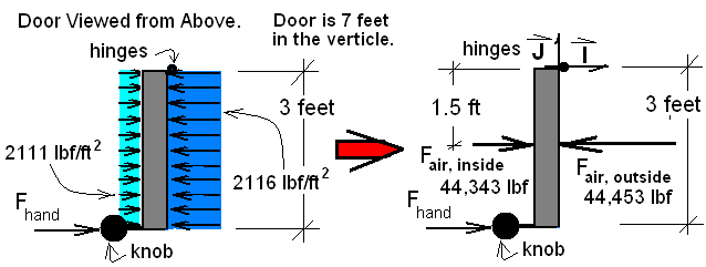

Two views of the door as a FBDare shown below. The door is view from above. Below left, the distributed forces of air are shown. Below right the distributed forces have been replaced by an equivalent single forces.
Door viewed from above; the door is 7 feet in the vertical. Left: the 3 feet wide door hinged at one edge with 2111 lbf/ft² on the inside face, 2116 lbf/ft² on the outside face, and F_hand at the knob. Right: resultant forces F_air,inside = 44,343 lbf and F_air,outside = 44,453 lbf acting 1.5 ft from the hinges, and F_hand at the knob 3 feet from the hinges, with unit vectors I and J.

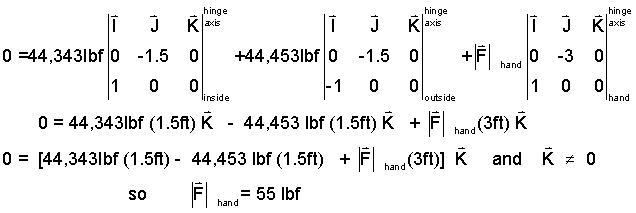

The door will pivot about its hinges as it swings outward. The sum of moments consists of three terms.
Equation (2): d/dt [r × mV] (door, hinge axis, struck out as zero) = Σ r × F; 0 = r × F (inside, hinge) + r × F (outside, hinge) + r × F (hand, hinge)
(2)2
We will use a vector approach. The sketch above right shows the I and J of our vector basis. The K is directed upward.
Equation (3): 0 = 44,343 lbf times the determinant |I J K; 0 −1.5 0; 1 0 0| (inside) + 44,453 lbf times |I J K; 0 −1.5 0; −1 0 0| (outside) + |F|_hand times |I J K; 0 −3 0; 1 0 0| (hand), about the hinge axis; 0 = 44,343 lbf (1.5 ft) K − 44,453 lbf (1.5 ft) K + |F|_hand (3 ft) K; 0 = [44,343 lbf (1.5 ft) − 44,453 lbf (1.5 ft) + |F|_hand (3 ft)] K and K ≠ 0, so |F|_hand = 55 lbf
(3) 3
The force calculated is 55.6 lbf. Thus it is likely you could open the door.
