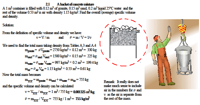

Language, terms and definitions are important to physics and thermodynamics. Correct us, if you will. Does the text example: "Borgnakke, Sonntag et al ~ Example 2.1" introduce a "new" property, the "overall (average) specific volume" and "overall (average) density."
A simple classification of a mixture is: homogeneous or non-homogeneous. Homogeneous means uniform throughout. The example from Sonntag treats its mixture as being homogeneous but the figure provided by the authors shows clearly that the mixture is not uniform throughout. Indeed, since air is included as a system component, the mixture cannot possibly be uniform throughout.
Concrete is a non-homogeneous mixture. Therefore the density the authors calculate does not apply to any randomly selected volume of the system mixture. In fact, density is not calculated, whereas an "effective density" is. The text solution is shown below.
Textbook excerpt, a bucket of concrete mixture: a 1 m³ container is filled with 0.12 m³ of granite, 0.15 m³ of sand and 0.2 m³ of liquid 25°C water, and the remaining 0.53 m³ is air of density 1.15 kg/m³; find the overall specific volume and density. The solution sums the masses to 755 kg, giving v = 0.001325 m³/kg and ρ = 755 kg/m³. Illustrated with a worker guiding a concrete bucket on a crane hook.

1) The specific volume and density obtained are special - untypical. Granite, sand, water and air comprise a non-homogeneous mixture. Consequently the density calculated does not apply to any small amount of the system material selected. Here proper use of density (for the constituents) is used to obtain an erroneous answer for the mixture. Put otherwise, suppose one were to scoop 1 meter cubed of material from the container. Would one expect that mass to be 755 kg? That would not happen.
2) The authors seek "effective" specific volume (and effective density) but have not provided equations for such calculations.
This is a poor example but it can be worked more logically.
3) In problem solution it is expedient to write the "operant" equation first. When a system is composed of a number of distinct materials, the density of those materials, taken together, is called its effective density with the symbol notation ρeff and the following definition:
Equation (1): ρ_eff = Σm_i / ΣV_i = (m₁ + m₂ + …) / (V₁ + V₂ + …)
(1) Effective density equals the aggregate
mass divided by the aggregate volume.
The general rule (above) applied to the constituents of the author's case yields:
Equation (2): ρ_eff = (m_granite + m_sand + m_water + m_air) / (V_granite + V_sand + V_water + V_air)
(2) Identify the constituents.
But the problem provides the density and volume of each constituent of the mix. So we rewrite the numerator sum:
Equation (3): ρ_eff = (ρ_granite V_granite + ρ_granite V_sand + ρ_water V_water + ρ_air V_air) / (V_granite + V_sand + V_water + V_air)
(3) To complete, enter the properties
of constituents and calculate.
The authors state the problem with air "included" then remark that the air "can be disregarded." There is no need to disregard the air. Just enter its effect and the numbers it contributes. Final calculations will show the contribution of air to the solution to be small, to be negligible.
