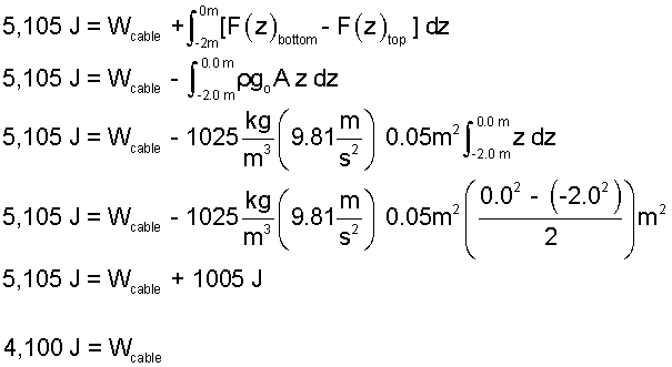

Returning to the energy equation (4) we write the work as being part that of the cable and part being that of the sea water.
Next we write the work of the sea water as the integral of its force as it varies over its displacement. These details are shown below.
As with all calculations at this level, the answer is only a bound. Since friction was assumed zero, 4,100 Joules is the theoretical minimum work required via the cable.
