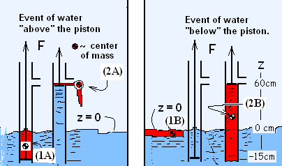

In the above equation, the initial kinetic energy of water "above" and "below" is assumed zero. Were the boat sinking, it is likely that water would be expelled from the pump with considerable kinetic energy (KE2). A simpler case, in which the second kinetic energy is assumed small (and ignored) provides the academic answer: "least theoretical work." We assume negligible kinetic energy changes. The initial and final states of the water with approximate elevations of their centers of mass are notated in the sketches below.
Equation (3): (PE₂ − PE₁) (c.m., water above) + (PE₂ − PE₁) (c.m., water below) = W₁₋₂
(3) 3
The left panel of the sketch shows states of the "water above" the piston. The initial elevation of its center of mass is 1A. That water flows from the pump at the elevation (2A).
Two sketches of the pump with force F on the handle. Event of water above the piston: its center of mass moves from (1A) near the bottom to (2A) at the spout. Event of water below the piston: its center of mass moves from (1B) at z = 0 to (2B) inside the column, between −15 cm and 60 cm.
The right panel of sketch follows the "water below" of our event. The initial elevation of its center of mass is: Z = 0 (at the surface, (1B) of the bilge water). The pump stroke brings the center of mass of "water below," up into the pump housing beneath the piston to a second elevation of (2B).
Changes of potential energy of the masses per upward stroke equal the mass times gravity times elevation change.
Equation (4): m g_o (z₂ − z₁) (c.m. above) + m g_o (z₂ − z₁) (c.m. below) = W₁₋₂
(4) 4

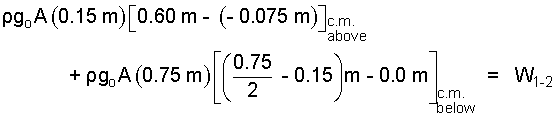

The individual masses equal the density of water times their volumes. In the drawing, initial and final elevations of the centers of mass are specified. The water free surface is taken as zero elevation.
Equation (5): ρ g_o A (0.15 m)[0.60 m − (−0.075 m)] (c.m. above) + ρ g_o A (0.75 m)[(0.75/2 − 0.15) m − 0.0 m] (c.m. below) = W₁₋₂
(5) 5

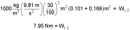

Now complete the calculation:
Equation (6): 1000 (kg/m³)(9.81 m/s²)(30/100²) m² (0.101 + 0.169) m² = W₁₋₂; 7.95 Nm = W₁₋₂
(6) 6
The above calculation gives the work by System Analysis of the water involved.

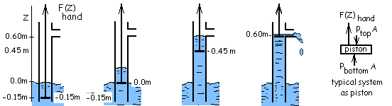

To integrate the force exerted by the hand through its displacement, a force-displacement diagram must be constructed. With the piston as system, the momentum equation is applied with very slow, near zero velocities. At selected elevations, the force required of the hand, F(z), is determined, graphed versus the vertical displacement, z, then integrated.
The sketch below shows four elevations of the piston as it is lifted. Right-most in the sketch is a brief free-body-diagram of the piston and its acting forces. The mass of the piston is assume negligibly small. The table beneath the sketch presents calculations for the lifting force applied to the piston at each of its positions (i.e., elevations, z).
Bilge Pump Work
Four positions of the pump piston as it is raised by hand force F(z), from −0.15 m through 0.0 m and 0.45 m to 0.60 m, and the typical system taken as the piston with F(z)_hand and p_top A above and p_bottom A below.
Graph of hand force F(Z) versus Z: from Z = −0.15 m the force rises linearly through region 3 (below 0.00 m) and region 2 to 8.1 ρgA at Z = 0.45 m, then stays constant through region 1 to 0.60 m; the value 0.66 is marked at Z = 0.
Next a sketch of F (abscissa) versus z (elevation) as the ordinate is drawn. The integration of hand force through its displacement is the area bounded by the ordinate and the function F(z). The work equals the area (1) plus the area (2) minus area (3).
W1-2 = [(0.15)(8.10) + (0.45 m)(8.10 + 0.66)/2 - (0.15)(0.66)]ρgA
W1-2 = 7.95 N m
