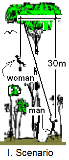

Scenario 1
To observe Harpy Eagles nesting, a naturalist built a blind in a neighboring tree. A line attached to a crossbow arrow was shot through the tree canopy. Next a hook is attached to a stout limb. Finally, by climbing pulley, equipment then the observer are hoisted "H" meters into the tree.
Two types of lift effected by the man are the Equipment Lift and the Self-Lift. For each type calculate:

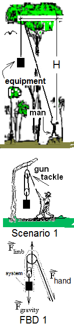

Equipment Lift:
Scenario 1 depicts this lift.
(i) Least Force Required: For a very slow, frictionless, "quasi-static" pull of the man, we apply Newton's 2nd Law with the system as the equipment, rope, and tackle: the free body sketch is FBD-1. For the "quasi-equilibrium" lift, the rate of change of momentum is "vanishingly small," so set "left-of-equality" equal to zero. The gravity force of the equipment is mequipgo.
E 01
(1)
Can this be solved? No!
Write as components to see.
In Eqn-1, the force subscripted "limb" and and that subscripted "pull" cannot be determined. When "unsolvable" is encountered, selection of a "smaller" sub-system of the first system might be a remedy. As sub-system of FBD-1 we choose, simply the lower pulley, FBD-2.
Hawks Nest Cc The boundary of the sub-system, FBD-2, cuts through three ropes of the lower pulley. We assume pulleys to spool without friction. Hence the rope tensions in the upward lengths (on opposite sides of the roller) are equal, TL = TR. A sum of moments about the pulley center will show this. Conclusions for FBD-2 are:
E 04
(2)4
Eqns-2 conclude each supporting line tension to equal mequipgo/2. By analysis of the upper (assumed frictionless) pulley we determine the pulling force: Fpull = 300N.
Hawks Nest D ii) Least Length of Rope Hauled:
The sketchs (right) (showing "initial" and "final" configurations of the pulley system) make it clear that the man must haul "2H" meters of rope.

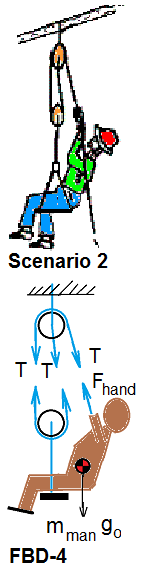

Hawks Nest 153px Second Lift: This lift is an effort whereby the man straps himself into the harness then hand-over-hand hauls himself upward. The sketch (right) shows the configuration of ropes and the man for that event. The gravity force acting is mmango.
(i) Calculate the force required of the man and the length of rope he must haul.
Auto Lift In a manner similar to the hoist of the woman, we see the force must be 300 Newtons and that 90 meters of rope must be hauled.
FBD Self Lift
