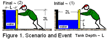

A tank contains a shallow body of water. Its bottom, left wall, and ends are fixed. The right wall can be pushed to the left and will remain vertical should that happen. Figure 1, scenario and event; tank depth L. Initial (1): a worker pushes a movable wall holding back water of depth L in a tank section of length 2L. Final (2): the wall has been moved so the water section is L long and 2L deep. Seals prevent all leakage of water. Figure 1. shows the wall in its initial and final positions.
Derive an algebraic expression for the "Least Work" required of the worker to push the wall a distance, L, to the left.

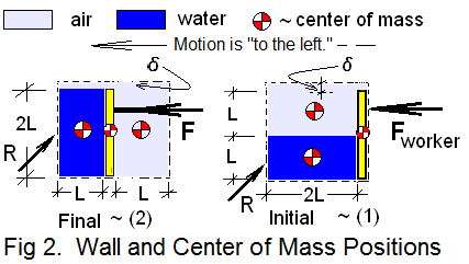

The wall and water are masses obviously involved with the event. When the wall moves the water moves; these masses are finite. However with movement, so also does the air above the water and to the right of the wall. So we contrive an imaginative system comprised of the wall, water and some of the atmospheric air. The "dashed-boundary" of Figure 2, identifies our system - the masses within that space which has a depth "L" into the page. The space does not move and mass neither enters nor leaves it.
As depicted in Fig-2, leftward movement of the wall (from (1))causes space above the water to be diminished but at the same time creates an equal amount of space right of the wall. As the wall moves, air (within the dashed-line system) from the left passes over the top of the wall and comes to reside in the vacated space right of the wall. For that to happen, our system sketch includes a small "passageway" above the wall, for air to move "left to right." The passage way is very small in height ,δ.
code
Fig-2 shows are centers of mass of the system components (air, water and the wall) in their initial, (1), and final, (2), states. A indicated is the ideal, "least force" applied by the worker to effect the event. A final symbolic force shown, R, represents the reaction of surroundings that maintain equilibrium of the system. This is our system for the Work/Energy Method.
Finally, notice that gravity forces on the wall, water, and air are not part of the system sketch. When the perspective, potential energy, is used it means Earth is considered "part of the system." The attractive gravity force, "Earth on mass" equals the force "mass on Earth." These act in opposite directions; they sum to zero.

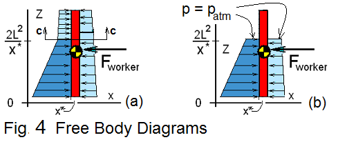

The next three forces (Eqn-10 - second line) act horizontally. These are caused by pressure of fluid-contact of water and air on the wall faces and the force oof the worker. A free-body diagram is needed now. Figure 4 shows the FBD of the wall at an arbitrary position, x*.
Fig. 4, free body diagrams of the wall at position x*: (a) water pressure, increasing with depth to height 2L²/x*, on the left face and F_worker on the right, with section c–c marked; (b) the same with atmospheric pressure p = p_atm also acting on both faces.
Figure 4(a) shows that the fluid-contact effect of air, acting on both sides, for the section of wall above section c - c is symmetric. Thus the force of air on the left is balanced by the same force of air on the right. Symmetry is a convenient condition. We might also see that patm acts on both sides of the wall and might be removed to have an even simpler FBD. Our choice is to use the FBD of Fig-4(b).
The directions of the forces of Eqn-10 are clear. Eqn-11 shows the forces at location, x = x*, written as integrals of pressure force, p(x*,z) over the wall areas of action, 0 ≤ z ≤ 2L²/x*.

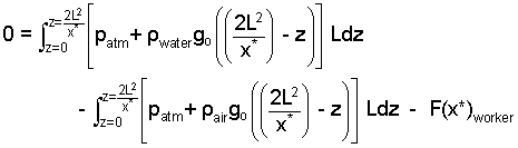

Equation (13): 0 = ∫ from z = 0 to z = 2L²/x* of [p_atm + ρ_water g_o ((2L²/x*) − z)] L dz − ∫ from z = 0 to z = 2L²/x* of [p_atm + ρ_air g_o ((2L²/x*) − z)] L dz − F(x*)_worker
(13)C240_e13

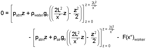

Below the integrations have been performed but limits have not been applied.
Equation (14): 0 = [p_atm z + ρ_water g_o ((2L²/x*) z − z²/2)] evaluated from z = 0 to z = 2L²/x* − [p_atm z + ρ_air g_o ((2L²/x*) z − z²/2)] evaluated from z = 0 to z = 2L²/x* − F(x*)_worker
(14)
Take care with
these manipulations.

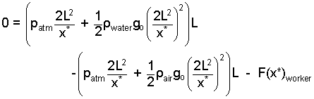

Do the step, "apply limits," carefully.
Equation (15): 0 = (p_atm (2L²/x*) + ½ ρ_water g_o (2L²/x*)²) L − (p_atm (2L²/x*) + ½ ρ_air g_o (2L²/x*)²) L − F(x*)_worker
(15)
The fluid-contact forces vary
with location, "x." This equa-
tion defines the force at the
inspecific location, x*.
Integrations are completed and the equation is "tidied-up". The next equation has only the force required of the worker as unknown. The equation applies at wall location x* but since this is an arbitrary location, the equation applies at all values of x.
