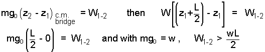

Fortunately, the potential energy change of the bridge is in the energy equation (left of equality). To calculate that is an indirect way of calculating the work. We use that approach with the definition of the bridge weight, W = mgo.
Equation (3): m g_o (z₂ − z₁) (c.m. bridge) = W₁₋₂, then W[(z₁ + L/2) − z₁] = W₁₋₂; m g_o (L/2 − 0) = W₁₋₂, and with m g_o = w, W₁₋₂ > wL/2
(3) 3
The use of energy change (left-of-equality) to determine work is convenient. Our answer is the least work required. Put otherwise, if your greatest capability for work is less than the calculated number - you will not raise the bridge.

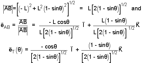

We calculate the unit direction first. The sketch to the right is needed. We recognize that eT, unit vector direction of T is equal to eAB. We write a vector equation that contains AB, then find its unit vector.
Equation (6): 0A + AB = 0B; L (cos θ I + sin θ K) + AB = L K; AB = −L cos θ I + L (1 − sin θ) K
(6) 6
Equation (7): |AB| = [(−L)² + L² (1 − sin θ)²]^(1/2) = L [2(1 − sin θ)]^(1/2), and e_AB = AB/|AB| = −L cos θ / (L[2(1 − sin θ)]^(1/2)) I + L(1 − sin θ) / (L[2(1 − sin θ)]^(1/2)) K; e_T(θ) = −cos θ / [2(1 − sin θ)]^(1/2) I + (1 − sin θ) / [2(1 − sin θ)]^(1/2) K
(7) 7

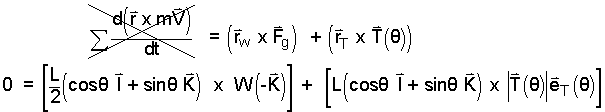

To determine the magnitude of the rope tension, |T(θ)|, we sum moments about the bridge hinge.
Equation (8): Σ d(r × mV)/dt (struck out as zero) = (r_W × F_g) + (r_T × T(θ)); 0 = [(L/2)(cos θ I + sin θ K) × W(−K)] + [L (cos θ I + sin θ K) × |T(θ)| e_T(θ)]
(8) 8

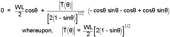

Be careful of signs while performing the multiplication:
Equation (10): 0 = (WL/2) cos θ + (|T(θ)| / [2(1 − sin θ)]^(1/2)) (−cos θ sin θ − cos θ + cos θ sin θ), whereupon |T(θ)| = (WL/2)[2(1 − sin θ)]^(1/2)
(10) 10
