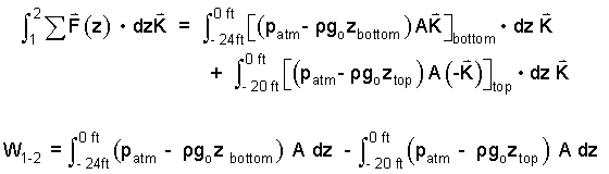

As regards work, the assumption of a frictionless event means the water will always contact the bottom (and top) of the model and exert a pressure-force always equal to the hydrostatic pressure times area. These pressure forces are displaced vertically. (Obviously no friction is pure fiction). We use the information above to write ΔPE. Also we write the first step in evaluation of the work.
Int F Z 3
(3)3
Next we calculate the work of the event, one step at a time.
Int F Z 4
(4)4
Recognizing that the values of integration over "z" are negative, we write the pressure expressions as "patm- ρg z" not, "patm + ρg z." The direction of the pressure force on the top is downward: (-K). Care must be taken in setting up the integral. The force on the bottom acts through the displacement, z, as: -24 ft ≤ z ≤ 0. The displacement of the top is: -20 ft ≤ z ≤ 0. We ignore any lifting effect of the air (once the model breaks the surface).

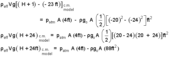

Int F Z 5 1
(5)5
When the first integral is written in two parts, its second part sums with the second integral to be zero.
Int F Z 5 2
(6)6
Be careful. Deal with units properly!

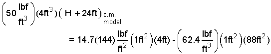

Int F Z 9a
(7) 7

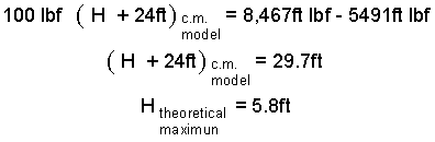

Avoid unnecessary, potentially harmful algebra.
Int F Z 9b
(8) 8
Int F Z 9c
(9) 9
Obviously the balsa model will not attain the altitude calculated. There will be plenty of friction. This ideal calculation serves as the basis for more detailed, friction-inclusive calculations. To solve using assumed idealizations is the first step in solving real problems.
