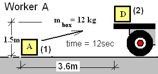

Basic mechanics can be used with the energy equation to evaluate the efficacies of work tasks. Consider the manners by which each of two workers moves a BOX (m = 12kg) kilograms from the storage floor to the tailgate of a truck. Use the data of the figures.
Worker A: a 12 kg box is moved in one straight path from position A on the ground (1) to position D on a truck bed (2), 1.5 m higher and 3.6 m away, in 12 sec.
Calculate:
i) the energy expended (J), and
ii) the average power (W), for the moving events of A and B as described below.
Worker A
From the floor (1), the BOX is lifted waist-high, then carried and placed on truck tailgate (2).

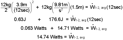

The least distance the BOX is moved in 12 seconds is [(3.6m)2 + (1.5m)2]1/2 = 3.9 m. Thus the kinetic energy the BOX must attain (at its very least) is written in (7) as:
Equation (7): (m_BOX/2)(d/Δt)² + m_BOX g_o (z₂ − z₁) = Ẇ_average Δt
(7) Least kinetic energy.
When numbers are applied to (7) the least average power expended by Worker A is obtained:
Equation (8): (12 kg/2)(3.9 m/(12 sec))² + 12 kg (9.81 m/s²)(1.5 m) = Ẇ₁₋₂,avg (12 sec); 0.63 J + 176.6 J = Ẇ₁₋₂,avg (12 sec); 0.063 Watts + 14.71 Watts = Ẇ₁₋₂,avg; 14.74 Watts = Ẇ₁₋₂,avg
(8) Least average power of Worker A.

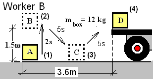

Next we investigate the task as done by Worker B. The image (below right)shows characteristics of the action as he moves a BOX onto the truck tailgate.
Worker B: the 12 kg box is moved in stages: lifted 1.5 m from A (1) to B (2) in 2 s, lowered to C on the ground (3) in 5 s, then lifted to D on the truck bed (4) in 5 s; the truck is 3.6 m away.
Excessive, disjointed
motion is wasteful.
Worker B
From the floor (1) needing 2 seconds the BOX is lifted waist-high (2). Carrying toward the truck requires 4 seconds but the BOX is dropped (3). Lifted again to waist-height, in 4 seconds, the BOX is placed on the tailgate.
The BOX location and properties, and event duration are the same as for Worker A. Results of that analysis can be used (with some thought).

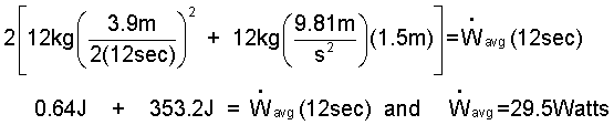

We can use information of the second line of (8). Worker B lifts the BOX twice and he squanders its kinetic energy when he drops it. For Worker B we have:
Equation (9): 2[12 kg (3.9 m/(2 (12 sec)))² + 12 kg (9.81 m/s²)(1.5 m)] = Ẇ_avg (12 sec); 0.64 J + 353.2 J = Ẇ_avg (12 sec) and Ẇ_avg = 29.5 Watts
(9) It is helpful NOT to rearrange
the terms until the last step.
