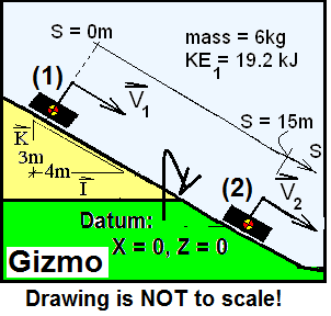

Sketch, not to scale, on planet Gizmo: a 6 kg mass with KE₁ = 19.2 kJ slides down a slope that drops 3 m per 4 m of run, from (1) at S = 0 m with velocity V₁ to (2) at S = 15 m with velocity V₂; datum X = 0, Z = 0 at the bottom of the slope.
On Planet Gizmo a small block was observed, State (1), sliding down an inclined plane. A "down-the-plane" coordinate, "s", was imagined with the block at its origin, s = 0 at the time, t = 0+. The mass of the block is: m = 8kg. Initially the elevation of the block and its kinetic energy were: zB,1 = 6m and KEB,1 = 4J, respectively.
A datum for vector space and potential energy (x = 0, z = 0) and a unit vector basis (I and K) are defined on the sketch.

gGIZMO = Note: These characteristics and properties can calculated but not in the order listed. Place answers in these boxes.

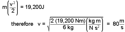

m (v²/2) = 19,200 J, therefore v = √[2 (19,200 Nm)/(6 kg) (kg m / N s²)] = 80 m/s

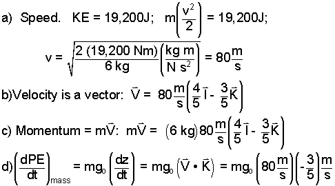

Write the Velocity as speed times direction.
a) Speed. KE = 19,200 J; m (v²/2) = 19,200 J; v = √[2 (19,200 Nm)/(6 kg) (kg m / N s²)] = 80 m/s. b) Velocity is a vector: V = 80 (m/s)((4/5) I − (3/5) K). c) Momentum = mV: mV = (6 kg) 80 (m/s)((4/5) I − (3/5) K). d) (dPE/dt)_mass = m g_o (dz/dt) = m g_o (V • K) = m g_o (80 m/s)(−3/5) m/s
Write its Momentum in component form.
