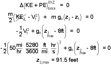

Ideal Bounce
p A son with his date is driving his father's Mercedes, safely, at 50 miles per hour but maybe a bit close behind a truck loaded with bricks. Placing her hand on his arm, his date says, "Oh Honey, is a brick falling off that truck?"
The sketch shows the scenario.
Is there any chance the brick might bounce over Dad's Mercedes?
♦  This will be a "batch" event that starts the moment the brick falls from the truck and ends at the greatest height it might attain finally.
About Approximation: In general, approximation means the disregard (or set to zero effect) of some aspect of the physical situation being analyzed. Approximation is always used and always simplifies problem analysis. To start, the physical terms and mathematic representations of systems and events, such as mass change, energy change, et al, apply only "on average." To model in finer detail yields better solutions but at the expense of dealing with wilder, unwieldy mathematics. Approximation is expedient but sometimes a necessity.
assuming a "perfect" bounce. For the brick taken as a BODY energy equation is:
jh
(1)1
For the "bounce event" the second possible elevation will be greatest when there is no work. So we assume "no work." Thus:
dd
(2)2
Wow! Our calculations predict the brick might bounce upward 90 feet. So there should be no problem for Dad's car... Right?
Our calculations assumed energy of the brick to be conserved. We know that won't happen. However, our calculations are correct - subject to our assumptions.
Although initial calculations require assumptions, their answers are not useless. With assumption our answers become a "bound" for reality. So what can his date say to this Dude with certainty?
Honey, the brick might bounce, but no higher than 91.5 feet!
