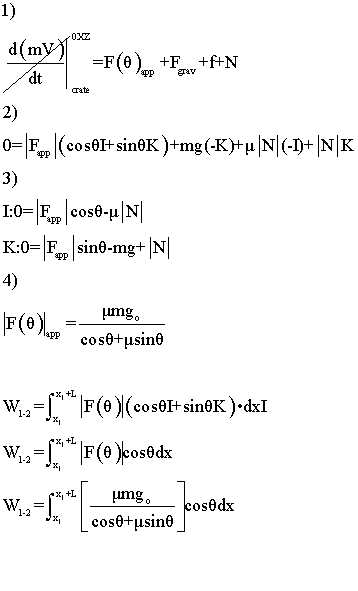

Optimized Move of a Crate
A force is applied to move a heavy crate across a horizontal surface. The coefficient of friction of the crate and surface is 0.3 (μ = 0.3). The crate is modeled as an extended body. The sketch shows its free-body-diagram and the orientation of the applied force. The event is that the crate is pushed a distance, L, to the right.
a) Obtain a general expression for the least magnitude of the applied force required, as a function of the angle of application of that force, θ.
b) Calculate the required force and work of the event for the angle of application, θ = 0
c) Calculate the least force required to accomplish the event and the least work.
