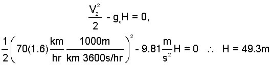

Eqn-2 reduces (below). Solution for the height is at hand, Eqn-3.
Equation (3): V₂²/2 − g_o H = 0; ½ (70 (1.6) (km/hr)(1000 m / (km 3600 s/hr)))² − 9.81 (m/s²) H = 0, ∴ H = 49.3 m
(3) 3
