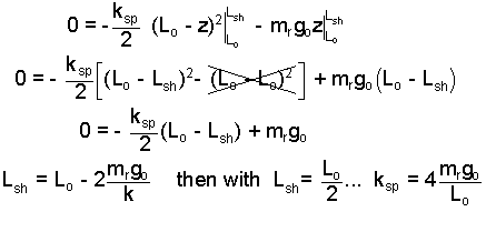

Now carefully integrate Eqn-4 and sort out the algebra.
Equation (5): 0 = −(k_sp/2)(L_o − z)² evaluated from L_o to L_sh − m_r g_o z evaluated from L_o to L_sh; 0 = −(k_sp/2)[(L_o − L_sh)² − (L_o − L_o)² (struck out)] + m_r g_o (L_o − L_sh); 0 = −(k_sp/2)(L_o − L_sh) + m_r g_o; L_sh = L_o − 2 m_r g_o/k, then with L_sh = L_o/2 … k_sp = 4 m_r g_o/L_o
(5)
This is the step-by-step integration
and algebra. Please check this!
Thus we have an equation for the spring constant we need.

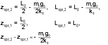

By the figure of the event, we can identify the Δ z's and the Δ L's.
z_r,2 = L_o − m_r g_o/k_s; z_r,1 = L_o; z_r,2 − z_r,1 = −m_r g_o/k_s
(11a)
Properties for the rock.
z_spr,2 = L_o/2 − m_r g_o/(2k_s), L_spr,2 = L_o − m_r g_o/k_s; z_spr,1 = L_o/2, L_spr,1 = L_o; z_spr,2 − z_spr,1 = −m_r g_o/(2k_s)
(11b)
Properties for the spring.

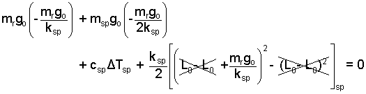

Now use the information of Eqn-12a and 12b. Enter the proper "differences" into Eqn-10.
Equation (12): m_r g_o (−m_r g_o/k_sp) + m_sp g_o (−m_r g_o/(2k_sp)) + c_sp ΔT_sp + (k_sp/2)[(L_o − L_o + m_r g_o/k_sp)² − (L_o − L_o)²]_sp = 0, with the cancelling L_o terms struck out
(12)
Energy increments made specific.
Collect the terms. See what things look like.
Equation (13): −m_r g_o (m_r g_o/k_s) − m_s g_o (m_r g_o/(2k_s)) + c_sp ΔT_sp + (k_s/2)(m_r g_o/k_s)² = 0
(13)

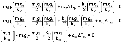

Can you "condense" this?
Some might say the mass of the spring is "small."
Equation (14): −m_r g_o (m_r g_o/k_sp) − (m_s g_o/2)(m_r g_o/k_sp) + c_sp ΔT_sp + (k_s/2)(m_r g_o/k_sp)(m_r g_o/k_sp) = 0; rearranged with c_sp ΔT_sp last; (m_r g_o/k_sp)(−m_r g_o − m_s g_o/2 + (k_sp/2)(m_r g_o/k_sp)) + c_sp ΔT_sp = 0
(14)
Algebra is the hardest part of physics.
We applied steadfast principles of physics. I'm going on vacation with my wife next week. I'll take this along and straighten out the algebra!
