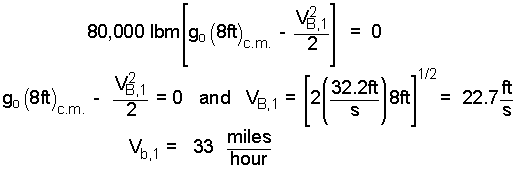

II. Calculate the least possible speed of engine "B."
♦  One witness said, "... the train was moving about ten miles per hour (~15 ft/s)." This sounds ridiculously slow. Now in the event, the kinetic energy of engine "B" transformed into its potential energy increase and the energy increase of damage of the steel vehicles. If we assume zero increase of internal energy of the engines then only the increase potential energy of engine "B" would happened. Our equation Eqn-5 can be solved for this limiting event. The answer obtained would be a lower bound. Let's run the numbers.
Batavia 8
(6) Leave algebra until the last step.
Consequently we know for fact that Engine B was travelling faster than 33mph.
