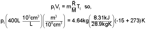

The Ideal Gas Equation is used to determine p1;
C324 E07
(7)
More algebra...
Finally, solve (7) for p1. Substitute the numerical value of p1 in to Eqn-6 (rightmost form). Write (T2/T1) as [(195 + 273)K/(-15 + 273)K]. Then run out the numbers.
