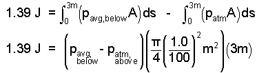

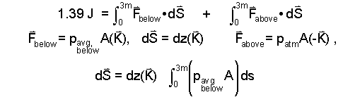

What average pressure was required of the hunter to blow the dart ?
♦ In the previous parts of this discussion of the dart we carried the work term as ΣW. With this calculation we expand that sum. After taking a deep breath, the hunter collapses his chest and diaphragm to expel air from his lungs. A pressure-force is caused to act over the bottom area of the dart. This pressure-force displaces up the tube. And as the dart moves upward, it must push away the atmospheric air ahead of it in the tube. Ignoring friction, the event has two forces and two components of work.
Equation (10): 1.39 J = ∫ from 0 to 3 m of F_below • dS + ∫ from 0 to 3 m of F_above • dS; F_below = p_avg,below A (K), dS = dz (K); F_above = p_atm A (−K), dS = dz (K); ∫ from 0 to 3 m of (p_avg,below A) ds
(10) 10
comment
Equation (11): 1.39 J = ∫ from 0 to 3 m of (p_avg,below A) ds − ∫ from 0 to 3 m of (p_atm A) ds; 1.39 J = (p_avg,below − p_atm,above)((π/4)(1.0/100)² m²)(3 m)
(11)11
We have the magnitude of the work from an above calculation. Atmospheric pressure is 101,300 Pa. Thus:
Equation (12): 1.39 Nm = (p_avg,below − 101,300 N/m²)(m³/4,244); p_avg,bottom = 107.2 kPa

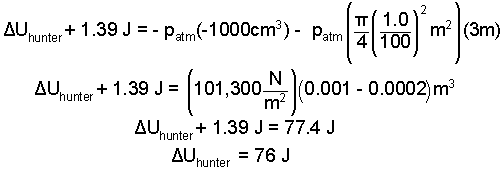

What energy change did the hunter experience? Obviously, physical exertion or "lung power" of the hunter fired the dart. The first step of the hunter was his deep breath. We assume his chest volume increased approximately 1000 cubic centimeters. We take the hunter and the dart as system. We strike friction and heats of the event and write the energy.
Equation (13): ΣΔ(U + KE + PE) (hunter, dart) = −Σ∫ from 1 to 2 of p_B dV (hunter, dart) + ΣW₁₋₂ − W₁₋₂,frict (struck out) + ΣQ₁₋₂ (struck out)
(13)13
Expand the equation to address the hunter and the dart, individually. Also recognize kinetic and potential energy changes of the hunter are zero and the change of internal energy and volume (compression work) are zero for the dart.
Equation (14): [ΔU + (KE + PE) (struck out)]_hunter + [ΔU (struck out) + (KE + PE)]_dart = −∫ from 1 to 2 of p_B dV_hunter − ∫ from 1 to 2 of p_B dV_dart (struck out) − W₁₋₂,ext
(14) 14
The work terms are special. When the hunter blows the dart his chest volume decreases by 1000 cubic centimeters. Thus the atmosphere collapses over the outside surface of his chest and helps blow the dart. In addition blowing the dart requires that the atmospheric pressure-force acting over the top area of the dart be displaced upward the length of the tube. This is work of the event passing from the system to the surrounding atmosphere.
Equation (15): ΔU_hunter + 1.39 J = −p_atm (−1000 cm³) − p_atm ((π/4)(1.0/100)² m²)(3 m); ΔU_hunter + 1.39 J = (101,300 N/m²)(0.001 − 0.0002) m³; ΔU_hunter + 1.39 J = 77.4 J; ΔU_hunter = 76 J
(15) 15
Subject to our assumptions, this result indicates an approximate efficiency of the blowgun event. The work accomplished on the dart amounted to 1.39 Joules. The "effort" of the hunter was 76 J. The efficiency of the event is (1.4J/76J) x 100 = 1.8%.
