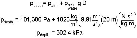

(i) The final mass of air in the tank is mfinal. When this air mass is attained the diver must surface. (Some breaths become available upon ascent, fortunately). The volume of the final mass is 0.0011m³. Its pressure will be "at depth." We use the hydrostatic equation to obtain the pressure, Eqn-3.
Equation (3): p_depth = p_atm + ρ_sea water g D; p_depth = 101,300 Pa + 1025 (kg/m³)(9.81 m/s²)(20 m)(N s²/kg m); p_depth = 302.4 kPa
(3)
Ambient pressure at the depth.

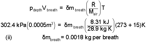

(ii) Each breath extracts a small incremental mass of air, a lung-full, from the tank. That extracted "mass per breath" is calculated to be:
Equation (5): p_depth V_breath = δm_breath (R̄/M_air) T; 302.4 kPa (0.0005 m³) = δm_breath (8.31 kJ/(28.9 kg K))(273 + 15) K; (ii) δm_breath = 0.0018 kg per breath
(5)
Mass of "air-out" with each "breath" event.
