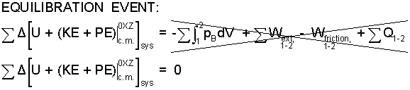

Equilibration Event:  System events with no work and no heat occur to systems constrained initially to have differences of energy among its energy types. Said system will stay that way (constrained) until the constraint is removed, whereupon the initial system energy re-distributes itself among its energy types subject to the constraints of the next state. Such changes are called "equilibration." For example, water flows to a new level or some ice and water become cold water. Heat and work being zero means all term right of equality are zero individually, not by event balance.
Energy Eqn 3a
(4) 4

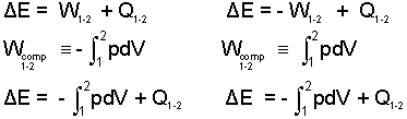

Sign Convention of Work  Many competent students upon finding thermodynamics difficult to understand apply proven learning skills to the task: extra effort, time and reading of other texts. As a rule, to read texts other than the assigned text is a good idea; thermodynamics texts can be an exception to that rule.
Work Signs Sys
A principal difficulty in cross-reading thermodynamics is the sign convention authors use for work. All terms left of equality associate with system energies - there is no sign difficulty there. Terms right-of-equality are energy change mechanisms of two types: work or heat. It is with work that the simplest equation of thermodynamics appears written oppositely. There being two conventions is troublesome to students.
Energy Eqn 3 2a
(7) 7

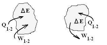

Two system symbols with "arrows" representing heat and work are drawn to the right. Beneath the images are written equations. In the left image and column (as in this writing), the simplest energy equation is written with work defined to be positive if its effect (in the absence of all other effects) is to increase system energy. By this definition work in the energy equation (W) is preceded by a positive sign in the equation. Compression Work is developed from the vantage that system volume is diminished (V2 - V1 is negative) with the piston force and displacement coincident, to conform, with the positive work definition, this integral must be preceded by a negative sign (the energy of a gas increases as its volume decreases, as it is forced into a smaller space). Both ideas combine to yield the result at the bottom of the left column of equations.
Other authors see work as positive with a decrease of system energy. In the image of "system" (the right side image) the work arrow comes out of the system. This way the work of an event is represented in the energy equation with a negative sign (the first equation in the right column). The view, Expansion work better suits this discussion. Expansion work, the second equation in the column takes a positive sign. But its integration and entry into its energy equation (with its convention) arrives at the same result - bottom equation of both column.
This means the thermodynamics of matter are the same irrespective of sign convention. Thermodynamically true, but lack of agreement among well-financed commercially dominant authors continues to foist this pedantic problem on students, fighting to learn thermodynamics. Enough already. Ancient mariners solved problems with convention: they invented "port" and "starboard." Mathematics solved the idea, "zero." Still thermo authors continue the pedantic debate, "Work is positive (tastes great), no work is negative (less-filling).
