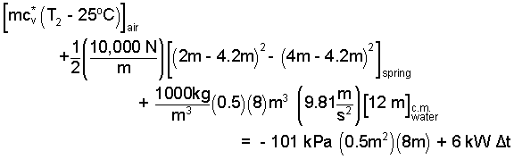

Relations for energy changes for the air, spring and water are:

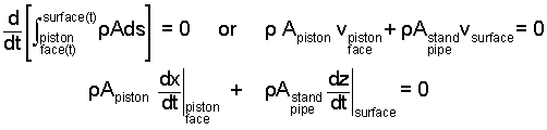

It is convenient to put some numbers into this equation. The only information about State (2) is the second elevation of the water in the stand pipe. We write a mass equation for the water with moving boundaries at the piston face and air/water interface. We apply a Leibnitz differentiation.

By checking, we see contributions of the spring and the water are correct. We turn those expressions into numbers.

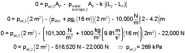

Our next task is to determine T2. The mass of air is constant. Its pressure, temperature and volume increase as it is heated. The second pressure can be calculated. In State (2) the force of the air on the right face of the piston equals the force of the water and of the spring that acts on the piston's right face. This will require the momentum equation for the piston. (We've done that before.)

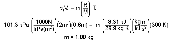

Next we calculate the mass and then use it to calculate the second temperature.

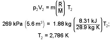

The piston displaces two meters to the right. Thus the second volume of the air is: V2 = (0.8 + 2.0)(2) m3. Returning to the ideal gas equation:
This required temperature is VERY high. The design won't work."
