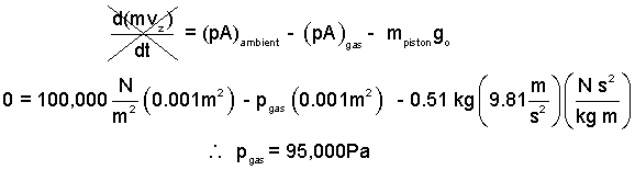

♦  We apply the momentum equation in the vertical to the piston to determine the pressure of the contained gas.
Candle Eqn 1
(1)1

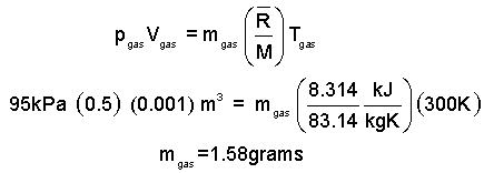

Knowing the pressure, the ideal gas equation will yield the mass.
Candle Eqn 2
(2)2

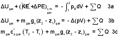

♦  We write an increment form energy equation with the contained gas as our system. The slow process will proceed at constant pressure. The boundary pressure, pB, of the work term will equal the gas pressure, pgas. The initial kinetic energy and final kinetic energy of the gas equal zero.
Candle Eqn 3a
(3) 3
The potential energy change is expressed as shown. The work of the gas equals its pressure times area over boundary sections that move (the piston face). Boundary pressure at the piston face equals the gas pressure, pgas, which is constant in the piston/cylinder arrangement. The work equals -Δ(pV)gas.
Candle Eqn 3b
(4) 4
Inspecting the above equation, we see the term ΔUgas, left-of-equality and -Δ(pV)gas, right-of-equality. A convenience occurs when we add Δ(pV)gas to each side of the equality.
Candle Eqn 3c
(5) 5

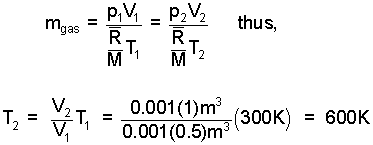

Above, we see that the work and internal energy change combined to become the enthalpy change of the event. We need T2. The mass of the gas is constant and so is the pressure.
Candle Eqn 4
(6) 6

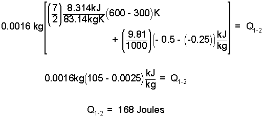

The change of potential energy of the gas is small but we calculate it to show how it is done.
If we take the top of the cylinder as a "z = 0" datum, then the initial elevation of the gas center of mass is: zc.m. gas,1 = - 0.25 m. The final elevation is: zc.m. gas,2 = - 0.5 m. Being an ideal diatomic gas, the specific heat at constant pressure is:
Candle Eqn 5
(7) 7
Now we are ready to put the numbers into the equation.
Candle Eqn 6
(8) 8
So, 168 Joules are required and the candle delivers 200. We conclude the piston will move downward and fall from the cylinder.
