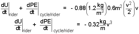

Bicycle racing is highly competitive; plenty of money is spent preparing riders and testing equipment. Approximate numbers for the drag coefficient for all aspects of performance are determined for each rider/cycle-combination. The frontal area of this investigation is 0.6m2, the density of air as 1.2kg/m3 and the drag coefficient, Cdrag equals 0.88. (For the sake of simplicity, We will use only one number for drag coefficient). This information entered into the equation yields a result suitable for any phase of a race.(all_phases)
C5500 E11
(11) 11
Eqn-11 is our general equation. It applies to the three cases.

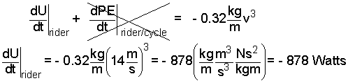

Time Trial Power  The rider completes a ride of 6.1 kilometers in 6 minutes and 52 seconds or an average speed of 14 meters per second. Calculate the steady watts of physical energy expended during the race. Since the time trial events occur on horizontal roads, potential energy changes equal zero.
C5500_e12
(12) 12
The power is negative meaning the energy of the rider decreases.

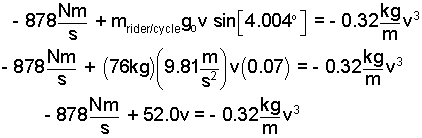

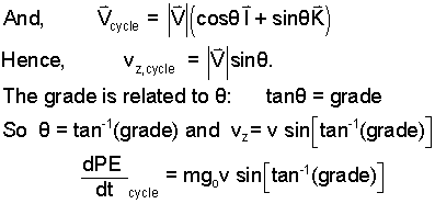

Constant Speed of Climb:   Zuphill PngDuring climb, the rider/cycle system will experience a steady rate of potential energy change equal to the mass times gravity times the vertical component of the road speed.
An intermediate calculation is needed:
e13
(13) 13
e14
(14) e14
Now return to the climb. We assume the rider capable of delivering the same sustained power in climbing as for the time trial. The grade is 7 in 100. Eqn-14 defined that power need. Drag (right-of-equality) changes as the speed cubed.
i05
e15
(15) e13a1
e13
(16) e13a2
A factor of the rate of potential energy change of the rider and Potential energy of the rider and cycle are related to road speed. The uphill grade is 7%. We Our energy equation we realize rate of climb is part of road speed. We can write dPE/dt in terms of the cycle speed and the grade of the slope.

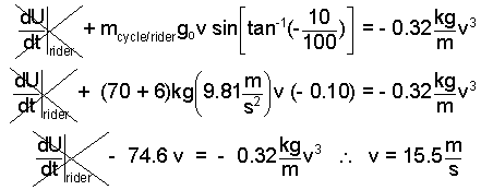

Constant Speed Downhill: The grade at 10% represents a steep, dangerous downhill. Our cyclist (no madman) will rest and coast.
i05
C5500 E17
(17) e17
