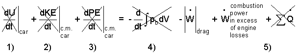

We take the car as our system. Since the car will have internal friction and an operating temperature, we model it not as a BODY but as a simple compressible substance. The energy equation is:

First we consider the case of horizontal motion; the energy equation reduces as follows:

  • (1) Since the vehicle has attained a constant temperature, its "dU/dt" equals zero.
  • (2) is zero because the speed is constant.
  • (3) is zero because the road is horizontal.
  • (4) The "simple compressible" car has a constant volume.
  • (5) The sum of heats to the car equals zero.
Our energy equation becomes:
