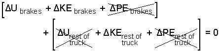

Summation signs are used to remind us that systems that have parts. We expand the equation to address the parts: the brakes and the rest of the truck.
In stopping on a flat road, neither the truck nor brakes experience change of potential energy. When the brakes get hot, their internal energy increases but the internal energy of the rest of the truck remains what it was.
The brakes and the rest of the truck have the same change of kinetic energy.
Our equation makes sense. The kinetic energy of the entire truck (brakes included) decreases. By design of the braking system, none of that energy passes to the surroundings (bad design?). To stop, the entire kinetic energy is relocated into the drums (and shoes) which become smoking hot (increased internal energy is evidenced the new, high temperature).
