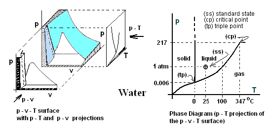

Ice, Water and Steam Of all substances, water is the most extensively studied. The basis for study of its thermodynamic properties is pure water. Investigations of water over broad ranges of imposed pressure and temperature, reveal distinct domains in p -T space in which water is solid and other domains in which water is liquid. Elsewhere in the p - T space, the water is gas (or vapor or fluid with minor distinctions). This information, presented graphically on pressure versus temperature coordinates, is called the phase diagram of water. Our discussions amount to presentation of experimental fact.
Phase Changes of Water Our first figure (below right) is a beginning phase diagram for water. The information, species of matter (water), molecular weight (18.0) and phase at STP 101.3 kPa and 25 °C (water) are called the standard state information of a substance. The state is notated on the phase diagram (SS). The notation, "liquid," (in the vicinity of the standard state) means that all proximate states are known, by experimentation, to be liquid. Next we consider three processes for an arbitrary mass of water. In each case the initial state is standard. The first two processes occur with pressure maintained at one atmosphere. In thermodynamics, the word normal means "at atmospheric pressure." Another term used is "room temperature" which mean means approximately standard temperature. In each of the cases below, assume we have a temperature measuring device inserted into the water.
Normal Freezing: In this event water, cooled at constant pressure, follows a path of states starting at SS then moving horizontally to the left as indicated below (right to left): "(A) <-<-<- || -<-<-< (SS)."
The water temperature diminished in a steady way from 25°C until 0°C, whereupon its temperature held constant and solid phase began to form. Thus the coordinates, pressure - temperature pair, 101 kPa, 0°C, mark a first point on a liquid-to-solid phase boundary of water. Cooling thereafter change all of the water to solid and thereafter the ice temperature diminished in a steady way, to -40°C. The region in the vicinity of state A is marked "solid." In summary, the cooling event changed the entire mass of water to solid at a special temperature.

In summary, these three events illustrate the determination of three points on the phase diagram of water which are at phase boundaries. These coordinate pairs, (101.3 kPa 0°C) (101.3 kPa 100°C), and (98 kPa, 25°C) when supplemented with a great many other pairs permit representation of phase boundaries as lines which are borders between regions or domains of phase in the p-T space. A completed set of such data when graphed, constitute a phase diagram of the substance.
Phase Diagram and p-v-T Surface The energy-related properties of water are pressure, temperature, specific volume, specific internal energy, and specific enthalpy: p, T, v, u and h. (Entropy is a topic of other texts). Since internal energy can be expressed as "u = h - pv," only the four properties, p, T, v, and h need be considered. An explanation of "dependence" is in order. In a laboratory, were one to impose on an amount of water, a specific (but randomly selected) pair of values for temperature and pressure, say T* and p*, the water would innately select and exhibit its measurable property, specific volume as v* = v(p*,T*). The inner energy or molecular structure of water itself "makes the decision," as to the magnitude: v*. Also decided by the water molecules is h* = h(T*,p*). (This is the case for all T*-p* pairs except those belonging to the phase boundary set). Thus a single, T* and p* set of data establishes a state or single point in the p-v-T space of water and results of vast experimentation (many many more sets) have produced (at least conceptually) a state space relationships among properties of a substance called its p-v-T surface. The surface is reasonably smooth with discontinuities at phase boundaries. The p-v-T surface for water is represented below left. To its right its p-T projection is sketched which we know as the phase diagram.
