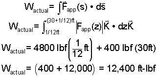

A laborer connects the boom cable to a pile. Then the operator powers-up the machine. The load sketch shows the machine lift force versus (z), the upward displacement of the top of the pile. The first inch, while the pile breaks free, taxes the equipment the most.
Calculate the weight of a sheet pile. When the pile is lifted the elevation of its top is 30 feet one inch and the lift force is 400 lbf. Thus:
Estimate the work required to extract one piling.

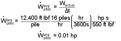

Calculate the horsepower expended.
♦ About 16 piles per hour are connected, lifted then disconnected. There are great losses between the horsepower rating of an engine and what actually gets done.
