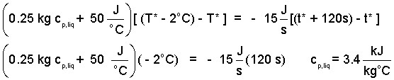

Measurement Process:  Measurement of the liquid specific heat is accomplished by observation of the cooling of the system from its beginning temperature, the condition expressed by Equation (12). A fundamental assumption here is, upon shut-off of the power, the "cooling rate" (being equal to the electric power), at the moment the power is turned off, will be constant for at least a few moments. For those moments this is true, the energy equation is:
D317 13
(13)(13)
Equation (13) contains the temperature of the liquid and of the instrument. For the equilibrium condition attained (Equation (11)), those temperatures are the same. We also assume them to be equal for the moments just after the electric power is terminated.
D317 14
(14)(14)
Finally, to obtain the average specific heat (over the two degree temperature range) we solve Equation (14). The procedure is to separate variables then integrate. The initial temperature is set to be T* which occurs at the instant the electric power is shut off, t*.
D317 15
(15)()
Finishing the details, we obtain:
D317 16
(16)(16)
