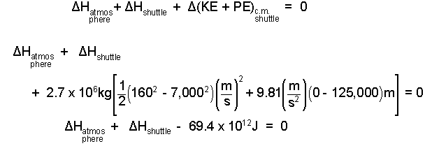

Next we rearrange and apply the numbers:
Equation (4): ΔH_atmosphere + ΔH_shuttle + Δ(KE + PE) (c.m. shuttle) = 0; ΔH_atmosphere + ΔH_shuttle + 2.7 × 10⁶ kg [½ (160² − 7,000²)(m/s)² + 9.81 (m/s²)(0 − 125,000) m] = 0; ΔH_atmosphere + ΔH_shuttle − 69.4 × 10¹² J = 0
(4) 4
This large amount of energy, initially possessed by the shuttle, agrees with what is known. When the shuttle re-enters, it dumps a great deal of energy to the atmosphere but in doing so a large amount comes to reside in the shuttle itself. This aspect of shuttle mechanical energy dissipation is called frictional heating of reentry.. But from our system perspective, the event is one of equilibration wherein the shuttle mechanical energy diminishes and the thermal energy of the atmosphere and shuttle increase. Shuttles are fitted with "heat shields" to protect them upon re-entry. We wonder just how big of a problem that much energy might be.

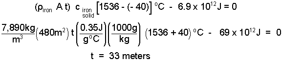

It is proposed, to act as a "heat shield," to attach a uniformly thick plate of steel to the bottom of the shuttle. As a first design, we assume the worst case, that the shield must absorb the entire energy change of re-entry distributed evenly in the shield and that none of the steel melts. Calculate the thickness of shield required.
♦  In accord with our assumptions the energy change of the atmosphere will be zero. The steel (iron) of the shield will experience a uniform energy increase to, but not to exceed, its melting temperature. We write the energy change of the steel in terms of its mass, average specific heat (as solid) and its temperature change for the event.
Equation (5): ΔH_atmosphere (struck out) + ΔH_shuttle − 69 × 10¹² J = 0; m_iron c_iron (T_mp,iron − T₁) − 69 × 10¹² J = 0
(5) 5
The mass of the slab of iron of the shield equals iron density times volume, or density times the area times thickness of the shield. A reasonable assumption for the initial temperature of the shuttle steel, deep in space, is -40°C. The steel can get as hot as its melting temperature which from the table is 1536°C.
Equation (6): (ρ_iron A t) c_iron,solid [1536 − (−40)]°C − 6.9 × 10¹² J = 0; (7,890 kg/m³)(480 m²) t (0.35 J/(g °C))(1000 g/kg)(1536 + 40)°C − 69 × 10¹² J = 0; t = 33 meters
(6) 6
I checked the numbers. That is a lot of steel. To attach a slab of steel 33 meters thick to the bottom of the shuttle is absurd. Sometimes a simple thermodynamic calculation will tell one just how silly is an idea is. But to give steel a second chance; suppose we design to let some of the steel melt and blow away.
