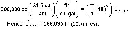

The volume of oil arriving per day is 800,000 bbl (British barrel measure). The diameter of the pipe is four feet. and 1 = 31.5gal/bbl and 1= 7.5gallons/cu.ft.)
Equation (3): 800,000 bbl (31.5 gal/bbl)(ft³/7.5 gal) = (π/4 (4 ft)²) L*_pipe. Hence L*_pipe = 268,095 ft (50.7 miles).
(3)3

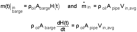

We developed this first order differential equation because some readers might not be familiar with it. The mass flow across the system boundary, m-dotin, equals the oil density time pipe area times flow speed. We now use constant hold geometry ( Abarge ) and constant density of oil to change the equation variable from mass to depth of oil, H(t).
Equation (12): m(t) (in barge) = ρ_oil A_barge H(t) and ṁ_in = ρ_oil A_pipe V_in,avg; ρ_oil A_barge dH(t)/dt = ρ_oil A_pipe V_in,avg
(12) 12

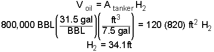

The velocity of oil delivered in the pipe, Vin,avg is the answer we seek. As the tanker is filled, the depth of oil, H( t ), increases from zero to a second height. A simple calculation gives the oil depth after 800,000 barrels are loaded.
Equation (13): V_oil = A_tanker H₂; 800,000 BBL (31.5 gal/BBL)(ft³/7.5 gal) = 120 (820) ft² H₂; H₂ = 34.1 ft
(13) 13
