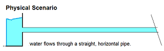

Fluid Phys Scen 50
So to bring the two ideas together. A BODY has its own coordinates and using a "material perspective" can be studied to predict physical events. For a fluid, "spatial coordinates" describe the fluid as a volume with special surface specifications possible when of use. For both perspectives to be true their mathematics and physics must be equivalent.

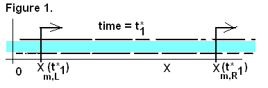

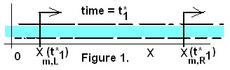

Figure 1 depicts a simple flow of a fluid in one dimension - X. The fluid (taken as incompressible, for now) has bounding coordinates (left and right) marked with subscript ("m") to mean a material designation: the coordinate "goes whever the particles it was first associated with go - for evermore.
Space 1
It is logical to identify a 1-D system as being that mass of fluid bounded by material coordinates ("m"). The "left" coordinate is notated "m,L" and "m,R" is the "right" coordinate. These coordinate points move in accord with the physics of the fluid. Assume the fluid incompressible and ideal; having no velocity profile (slug-flow). Let the selection of system occur at time "t*1".
The super-script asteric, " * ", notation admits that the system selection was made at a specific ("t*") instance in time. At the end of development, realizing in retrospect, the "instant of time" could have been "any instant." Upon completion of the proof, the notation is changed: (t*) becomes (t).
Specification of material coordinates as boundaries (left/right moving) with fluid particles, assures us that the bounded mass, the material mass is constant:

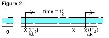

It is our choice to manipulate the equations of the "material perspective," however we choose provided math rules are not violated. A natural perspective of persons observing events of fluids is "spatial." The perspective is "instantaneous" and of the same space as the material space. Figure 2.
Space 2
Next we write an equation that applies superposed to Figure 2. We define velocities of a "spatial perspective" to have the notation: W. Headed toward the transformation, we write an equation of identity.

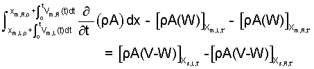

I admitted that this is not a proof - parts are missing. Specifically I'm sure that adding the lower equation to (4) must also have a change of limits of the integral. (Right now I'm tired - something is wrong.) A step further yields:
Rey 7
(7)(7)
So there is discretion in specifying W. But not V; it is determined by physics. W is the human-selected, possibly spatial, view. When W is set equal to V everywhere, the terms right of equality become "zero" and (7) collapses (in a proper way), returning it to its parent, (4).
Another case is when W is set identically equal to "0." I believe a constant-volume, "spatial perspective" results. The right side terms become the mass-rates "in" or "out" often used in texts.
This proof is inadequate. I think the limits of the integral must change but right now I am unsure how. Help me if you will.
