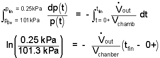

Freeze drying of the snakes commences once the chamber pressure attains 0.25 kPa. During pump-down, air is removed at the constant volumetric rate: V-dot = 1 x 10-6 m3/min.
Calculate the least time required for the pump-down process. Note that this is just the first stage of snake treatment. The pump will need go much longer as the water diffuses out of the snake to "dry" it. We don't know how fast the water will leave the snake.

Now, by the equation, we see (by the term right-of-equality) that as air is "slowly" pumped from the space the pressure of air within the space decreases. Next write the mass rate of the mass expelled more explicitly. That is, m-dot, equals the instantaneous density of the system air times the volume rate of the pump, "V-dot".
(5) 5
Next we substitute the ideal gas relation (above right) into the mass equation (above left). Please check the substitution and rearrangement - it should be:
(6) 6
We solve this first-order in the identical manner all of the previous equations. Separate variables, apply integration with proper limits and use integral calculus.
(7) 7

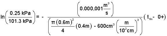

Remember to subtract the volume of the snakes from the chamber volume. Or should we?
(8) 8

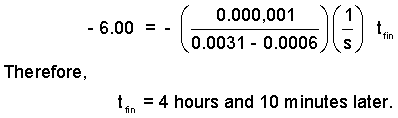

Proceed with the algebra.
(9) 9
Having an answer, we think about our assumption of constant temperature of the system air. It would seem the 4 hours would be slow enough that the air inside would stay at -20°C.
