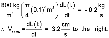

The system mass equals ρAL(t). Zero fluid enters. Fluid exits the system at a rate (at the exiting boundary) of 0.2 kg/s. So...
Equation (2): d[ρAL(t)]/dt = 0 − 0.2 kg/s
(2) The fluid density and piston area are constant.
The fluid density and piston area are constant - move them out of the derivative. Apply numbers of the geometry. The piston speed can be obtained.
Equation (3): 800 (kg/m³)(π/4 (0.1)² m²) dL(t)/dt = −0.2 kg/s, ∴ V_piston = dL(t)/dt = 3.2 cm/s to the right.
(3) The piston speed can be obtained.
