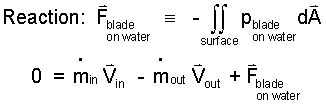

Force
However, we can bypass that integration. Knowing it will yield a force, we represent the distributed pressure-forces as a single force which is called the reaction of the jet. A reaction is a force at the system boundary caused by the surroundings which effects the equilibrium of a system upon isolation. The reaction is a force on the water. Our system now looks as shown to the right.

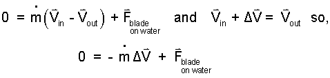

One more small step is generally applied. The entering and leaving mass rates are equal. Hence the equation can be rewritten to cast the velocities as a velocity change, as ΔV.
Jet 4
(4)
Common final form.

The velocity diagram (right) is constructed by drawing Vin and Vout then drawing a vector from Vin to Vout; that vector is ΔV. This diagram result is entered into the momentum equation:
Jet 5

Much of the difficulty in applying the momentum equation arises with system selection. It is advised to select the system to be the moving fluid. Do not include the steel of a blade or any matter other than the fluid. Thus one solves for the forces supplied by surroundings that cause the system momentum changes - this is called the reaction. Above we determined the force; an angular-momentum analysis is required to determine its location.

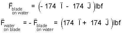

Force of Water on Blade:  A common next step is to determine the force of the jet of water on the blade. Our system analysis provided the force of the blade on the water, therefore the negative of this force equals the force of the water on the blade.
Jet 8
(8)
So the water seeks to push the blade "up" and "away."
This makes sense!
So the water seeks to push the blade "up" and "away." The approach of having the system being the moving fluid only is the best way for beginners. Friction occurs, our answer is approximate.
