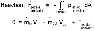

The distribution of operating pressure-forces is not known. The force associated can only be approximated. To proceed, it is imagined as "summed," then graphically represented on the system sketch as the system "reaction," (magnitude and location unknown). In this case the sum of forces on the water by the blade.
Equation (3): Reaction: F_jet ski on water ≡ −∬ over surface of p_jet ski on water dA; 0 = ṁ_in V_in − ṁ_out V_out + F_jet ski on water
(3) What pushes what gets confusing.
Remember: the system is the water.

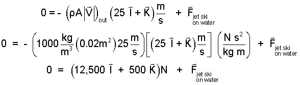

The vector diagram determines ΔV. Vector diagrams might seem unnecessary. They are greatly needed later; a little practice now is advised.
Equation (5): 0 = −(ρA|V|)_out (25 I + K) m/s + F_jet ski on water; 0 = −(1000 (kg/m³)(0.02 m²) 25 m/s)[(25 I + K) m/s](N s²/kg m) + F_jet ski on water; 0 = (12,500 I + 500 K) N + F_jet ski on water
(5) 5
Cable force
Sketch of the jet ski with the cable tension T_cable through the spring scale, and the X-component of the water force on the jet ski, F_X. Finally draw a simple free body sketch of the jet-ski. We know the jet ski floats; the sum of forces in the vertical equals zero. The cable resists the X - component of the force of the water on the jet ski.
Tcable = 12,500 N
