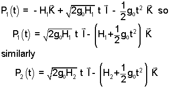

Before we can write the "positions" of the two droplets, we must decide upon coordinates, origins and a vector basis. The setup needed is shown below right.
Notice the two red dots; they are our system, two droplets. Solutions of Newton's equations for projectile motion are:
An interesting aspect of this event is that the time scales, or clocks, that apply to the droplets that collide are distinct. The starting time and time of the droplets are not the same. Put otherwise, droplet 1 issues from the wall before does droplet 2. The droplets meet at an instant in time say, timpact but the times of the paths are different. Collision occurs when P1(t1*) = P2(t2*)
