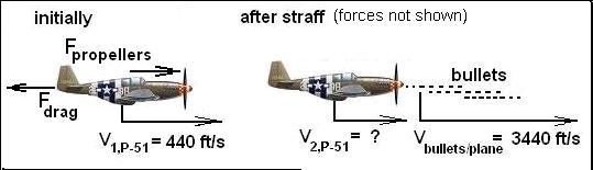

On strafing runs WWII P-51 Mustangs often fired bursts of 1000 rounds from its six - 50 caliber machine guns. Those streams of "fired" lead changed the air speed of the Mustang. The details of strafing are complex. This calculation will include some "guess-work" and approximation. The sketch includes hypothetical data of one near-horizontal (tree-top level) P-51 strafing event.
Calculate the P-51's change of air speed after it fires a burst of 1000 rounds.
♦ We take the system to be the mass of the P-51 and the mass of the ss1000 rounds of 50 cal bullets. The P-51 mass was about 5400 pounds. Its speed about 300 miles per hour (440 ft/s) when firing commenced. The bullet masses we take as 0.1 lbm. They left the machine gun muzzles at about 3000 feet per second. A simple, before-after sketch is helpful.
Two sketches of a P-51 (forces not shown after the strafe): initially, flying at V₁,P-51 = 440 ft/s with propeller thrust F_propellers and drag F_drag; after the strafe, the plane's speed V₂,P-51 = ? and the bullets leaving at V_bullets/plane = 3440 ft/s.
Assume the drag force of air initially to be
“about” the same finally.
We take the airplane and the bullets it carries (then fires in the event) as our system. Since there is "plane" momentum and "bullets" momentum, we place a summation, left of equality, on momentum.

Initial Condition
An event is a change from some initial condition to a final condition. Initially the plane and bullets move horizontally at same constant speed. The state is called uniform motion. Propeller thrust causes the velocity, the drag (the opposing force of air as the plane moves through it) equals the thrust force. So velocity and momentum are constant for all times prior to firing (t < 0+). Stated by equation, this is:
Equation (2): d/dt [ΣmV] (P-51 and bullets, 0XZ, struck out) = ΣF; 0 = F_drag + F_propeller
(2) Momentum is constant and the force of the prop equals that of aero-dynamic drag.
Eqn-2 tells that prior to firing the system momentum is constant in two ways. Left-of equality says the bullets and aircraft speeds are constant. Right-of-equality says "thrust equals drag."

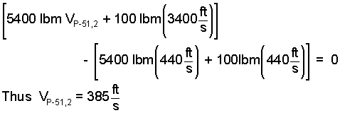

The direction of all vectors is to the right, so we scalar multiply or "dot" multiply ("• I") the equation then put numbers into it.
Equation (7): [5400 lbm V_P-51,2 + 100 lbm (3400 ft/s)] − [5400 lbm (440 ft/s) + 100 lbm (440 ft/s)] = 0. Thus V_P-51,2 = 385 ft/s
(7) As always, care with
units is essential.
This amounts to a worrisome, 14% decrease in speed. We suppose 14% is the least reduction. In events of "squandered energy," approximations tend to be "rosy."
