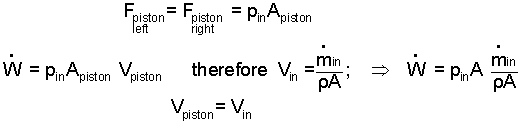

The algebra goes like this. First for W-dot (above left) both vectors have I components: W-dot = |F||V|. Next the speed of the piston, |V|piston is equal to speed of the water moving across " in ", (|V|in). The force on the left face of the piston equals the force on the right face which equals the (average) pressure of the water on the right face times the piston area. The speed of the piston equals the speed of water moving across the plane " in. "
Equation (5): F_piston left = F_piston right = p_in A_piston; Ẇ = p_in A_piston V_piston, therefore V_in = ṁ_in/(ρA); V_piston = V_in ⇒ Ẇ = p_in A (ṁ_in/(ρA))

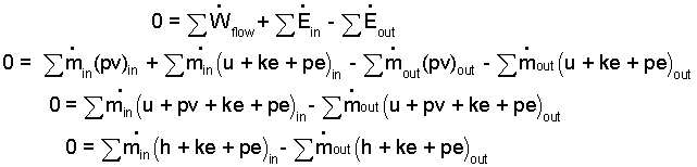

Now, imagine there are many "in" and "out" planes, each with its flow work and energy rate. Let the situation be steady in time. We write the energy equation then collect it. Immediately we see the sum, u + pv appears. This is the second instance when that group was needed. Enthalpy is a very convenient variable. The sum is represented as "h." Our energy equation for this is:
Equation (8): 0 = ΣẆ_flow + ΣĖ_in − ΣĖ_out; 0 = Σṁ_in (pv)_in + Σṁ_in (u + ke + pe)_in − Σṁ_out (pv)_out − Σṁ_out (u + ke + pe)_out; 0 = Σṁ_in (u + pv + ke + pe)_in − Σṁ_out (u + pv + ke + pe)_out; 0 = Σṁ_in (h + ke + pe)_in − Σṁ_out (h + ke + pe)_out

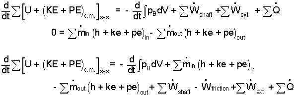

The above development was done for a steady system at no harm to the development but a savings in writing. To obtain our system equation from energy, our last energy equation we simply replace the leading "0" (for steady) with the other familiar term.
Equation (9): d/dt Σ[U + (KE + PE)_c.m.]_sys = −d/dt ∫p_B dV + ΣẆ_shaft + ΣẆ_ext + ΣQ̇ … 0 = Σṁ_in (h + ke + pe)_in − Σṁ_out (h + ke + pe)_out; combined: d/dt Σ[U + (KE + PE)_c.m.]_sys = −d/dt ∫p_B dV + Σṁ_in (h + ke + pe)_in − Σṁ_out (h + ke + pe)_out + ΣẆ_shaft − Ẇ_friction + ΣẆ_ext + ΣQ̇
