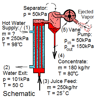

Tomato Juice New Tomatoes and tomato juice are easily damaged by high temperature. Concentration of tomato juice is accomp­lished using modest heating (by hot water in a heat exchanger) followed by mechanical extraction of water by action of a vane pump. The vane pump maintains a low pressure over the juice and ejects water as vapor from the separator.
The concentration process has two flow streams. Hot water (1) enters, cools as it passes the juice (in counterflow) then exits (2). The other stream, juice, enters, (3) is warmed then enters the separator where its stream divides into concentrate exiting as liquid (4) and vapor exhausted by the vane pump (5). Use the information of the drawing.
Calculate the mass rate of water that exits the vane pump as water vapor (5).
♦  By the Schematic, we visualize the system as juice which enters ar (3) at 250 kg/hr and exits as concentrate at 180 kg/hr and as vapor ?kg/hr. The mass equation for steady production of concentrate is:

Calculate the mass rate of Hot Water for this system.
♦ Take the heat exchanger as system and assume it is frictionless and adiabatic. The event is steady and there is no work. The energy equation is:

Calculate the least horsepower of the vane pump.

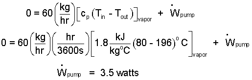

♦  We write the energy equation for steady operation of the vane pump. The kinetic and potential energy changes of the flow of vapor through the pump are negligible. The vapor passes through the pump quickly with too little time for heat.
(5) 5
The mass rate of vapor was determined above. The entering and leaving pressures are provided and the entering temperature is 80°C. Being asked for the LEAST work, we set the friction to zero. We enter these numbers into the energy equation:
Tom Eqn 7
(6) 6

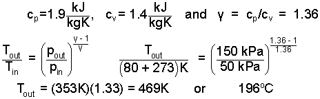

Eqn-6 contains three unknown quantities which are the exiting temperature of the vapor, the work rate of compression and the friction loss work rate. To continue in solving Eqn-6 we require another condition or relation for the process. That condition is that the vapor proceeds along an adiabatic-frictionless path. Water vapor at this low pressure can be approximated as an ideal gas with specific heats and a specific heat ratio of:
Tom Eqn 8
(7) 7
We return to the energy equation with this information.
Tom Eqn 9
(8) 8
