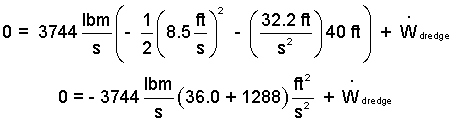

Numbers can be applied to the reduced Energy Equation, Eqn-5. Note: Please resist the urge to "do algebra" on this equation. It has meaning that is lost upon algebraic rearrangement.
Equation (7): 0 = 3744 (lbm/s)(−½ (8.5 ft/s)² − (32.2 ft/s²) 40 ft) + Ẇ_dredge; 0 = −3744 (lbm/s)(36.0 + 1288)(ft²/s²) + Ẇ_dredge
(7) ♦ An equation contains a solution once it is
ALL numbers, with only one unknown remaining,
represented by its symbol.

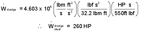

Conversion to HP requires unit manipulation...
Equation (8): Ẇ_dredge = 4.603 × 10⁶ (lbm ft²/(s s²))(lbf s² / 32.2 lbm ft)(HP s / 550 ft lbf), ∴ Ẇ_dredge,ideal = 260 HP
(8) ♦ Do the algebra now. Apply the
necessary unit conversions.
First, the answer is positive, meaning energy of the system (the water flow) was increased. Next, the answer we obtain is ludicrously small. There are inexpensive motorcycles that require 260 horsepower engines. This being a beginning level discussion, we have assumed friction nonexistent. Friction is never zero; it is BIG. To include effects of friction requires advanced study and/or expensive experimentation.
