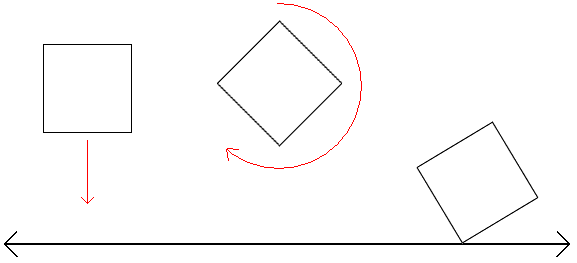

I would suggest starting with a 2-D version of the problem. Consider a square object falling onto a plane with an arbitary linear velocity, angular velocity, and orientation when it hits the table.
Alright, I'm guessing that when you talk about "linear velocity", "angular velocity", and "orientation when it hits the table", you're talking about these three things, respectively:

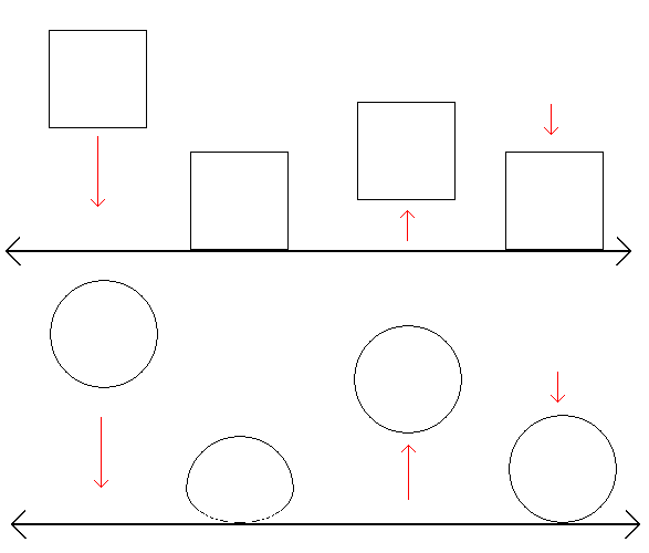

The coefficient of restitution is a measurement of the elasticity of a collision. A superball has a high C.O.R., a die has a low one- this is the ratio of velocities before and after impact. Conservation of linear and angular momentum is what you suggest, but subject to COR correction during impact and soon after it, friction. Its a bear of a problem to be taking on with so little experience; I admire your gumption.

I'm slowly beginning to put together the various factors involved. The description you gave was very clear, thank you. Here's my understanding of what you've described of C.O.R so far:
...comparing a die versus a super ball.

The angular velocity is actually a vector, which is defined by the following relationship:
\ \vec[v]=\vec[\omega]\times\vec[r], where each component is the velocity of rotation around an axis perpendicular to the x, y, and z axis (arbitrary axis can be chosen to make the mathematics more manageable)
In the 2D case you are investigating, imagine an axis perpendicular to the plane in which the object is rotating (This is the direction of this component of the angular velocity), with magnitude omega. Then \vec[v]=\vec[\omega]\times\vec[r]\rightarrow \left|v\right|=\left|\omega\right|\left|r\right|sin(\theta), where theta is the angle between the two vectors (Omega and r, which in this case is 90 degrees). The bars denote the Euclidean norm, or the "length" of these vectors.
omega is the rate of rotation in rad/s. r is a vector extending from the origin of the point of rotation to the point who's angular velocity you are interrogating, and v is the tangential velocity vector of that point at that given instant. Here since r and v are coplanar, omega points out of the page (call this the z direction), and you can solve for omega, and get that formula from wikipedia. In general, rotational dynamics are pretty complicate as what is called the body's "Moment of Inertia Tensor" and angular velocity vector both change with time (you can visualize this), thank of the inertia tensor as a matrix which tells you the tendency or willingness of the object to rotate around a given axis.
