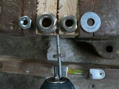

Here's my experiment that should be easy to reproduce. It did get one result I wasn't expecting. The reader might not be so surprised, however.
Materials used:
right handed wood screw (made of metal)

In all cases the inside diameter of the nuts and washer were much greater than the diameter of the thread on the screw. This set up meant that the nuts and washer appear to 'hang' from the screw, rather than be threaded onto screw.
The female thread lead of the nuts wasn't measured but appeared to be smaller and the thread angle to the axis, greater.
Method and discussion:
The head of wood screw was clamped between the two small pieces of wood which in turn, was clamped by the vice. The screw protruded horizontally from the vice and this was checked as best as possible with the spirit level.
The washer was used for the first trial and was placed about half way along the wood screw. The drill was set to its highest speed and the drill bit applied parallel to the length of the screw and close to its end such that splines on the drill bit impacted the thread.
Interestingly, the washer began to slowly rotate (counterclockwise) in the opposite direction to the drill (clockwise). It did not move up or down the screw. Note that the thickness of the washer is less than the thread lead and the washer remained in the groove of the thread where the washer and screw were in contact. The drill was then set in the opposite direction (counterclockwise) and the washer began to slowly rotate in the opposite direction (clockwise). It did not move up or down the screw.
Different 'sides' of the screw were tried: left, right, top and bottom. All had the same effect.
The drill bit was then applied perpendicular to the screw such that the splines impacted the point of the screw. The washer rapidly bounced toward the head of the screw and it was impossible to tell if it was rotating.
The nut numbered 1 was then tried with the bit parallel. All sides were tried and the results were the same as those for the washer except that the nut traveled toward the head, following the thread, when it rotated clockwise and toward the end where the bit was being applied when it rotated counterclockwise. If it traveled too close to the bit, the nut would 'jump' thread back toward the head.
The drill bit was then applied perpendicular to the screw and nut 1 rapidly bounced toward the head of the screw and it was impossible to tell if it was rotating.
The same results were obtained for nuts 2, 3 and 4 except that some rotation was observed when the drill bit was applied perpendicular; although it appeared erratic and no overall trend in one direction was observed.
Comments:
As for the nuts to moving up and down the thread, it wasn't a slow process. I suppose each nut would have done a full turn in about a second but I didn't measure this and the rate of turning appeared to vary.

In the image you can see nut number 1 with the drill bit aligned on the left side of the screw in the parallel position. Not exactly aligned: it's hard to take a photo with one hand and hold the drill in the other. The point of view is from above the rig.
Also visible is the vice, wood, washer and the other nuts. The level can be just made out in the background.
It would have been great to make a short movie clip of the nuts moving along the screw, but as far as I know they can not be uploaded to PF and I do not a have a rig to secure the camera or an assistant. Yes, it's lonely work.
The results of this experiment imply that with the right 'vibrations' it might be possible to unscrew a screw that say, has it head sheared off or is a one-way slotted screw. The perpendicular drill bit trials suggest that a screw would 'wriggle' its way out if not for the fact that a tight thread prevents 'jumping'. The parallel drill bit trials suggest a screw could turn its way out assuming the torque overcame frictional forces. The interesting bit is that, assuming there is enough of the screw protruding from the surface to apply a drill bit parallel, one would set the drill motor rotation anticlockwise, as if to screw a right-handed screw out. Intuitively, without doing the experiment, I would have thought to apply a parallel drill bit clockwise and attempt to engage the screw like a cog: forcing it to turn anticlockwise and therefore out.
