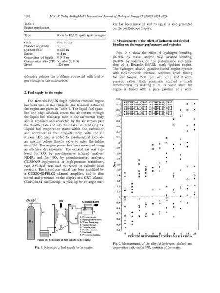

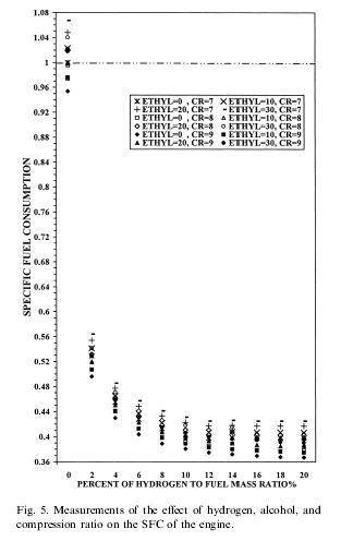

Your right. I have made around a 30% claim, which is based on personal experience. Readers can choose to determine the validity of this claim for themselves. Skepticism should persist because of the controversial nature of the topic, so your standard is very fair.
However, if one looks at post #'s 48 and 63 on the thread, they will find another graph, which easily shows a value much closer to %30, if a 1% hydrogen mass fraction production via electrolysis is analyzed. Of course, the study was done on a test engine, so the argument can be made that the transformation of the results to an actual car engine may not be the same.
Here is the graph
https://www.physicsforums.com/attachment.php?attachmentid=14729&d=1216251641
and the experimental setup and test engine specs
https://www.physicsforums.com/attachment.php?attachmentid=14746&d=1216420235
You have made a claim as well, which was proven to be inconsistent with the presented facts.
So, where does this leave us? It should appear to any reader with little research on the topic that the idea is at least plausible, and that the idea may require experimental testing rather than armchair science, since cars and their parts associated with the operation of the device vary over a wide spectrum.
