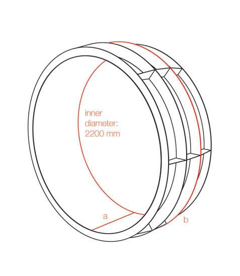

Perspective line drawing of a large wheel-like ring structure with an inner diameter labelled 2200 mm, a red dimension line for width a, and a red circle marking diameter b on the outer ring.
Dear all,
Above is a proposal for a human wheel I would like to make, the inner cylinder would be perforated, similar to http://boards.core77.com/viewtopic.php?t=18087 . The difference with a hamster wheel is that it wouldn’t be stationary and is able to take ( large ) bends. The ribs seem rounded, but that’s only an optical illusion. The intention of the wheel is to give an alternative to the walking paths ( paved green space to keep your shoes clean ) in parks, a new experience with more freedom.
I guess the thickness of the materials, the amount of crossbars and the diameter of the outer rings are easiest to decide on the spot. The structure as drawn above would weigh ±80kg in TIG welded aluminium AW-5083 with anti-slip paint, maybe fibreboard is an option too.
But I was wondering how to define the:
- width of the cylinder a
- diameter of the two rings in the middle b
to make sure:
1) the wheel is not too heavy to make it start/stop rolling
2) it is not too difficult to make the wheel lean to one side
3) the wheel is unlikely to fall
( 4)the bends it can take are not too large )1)

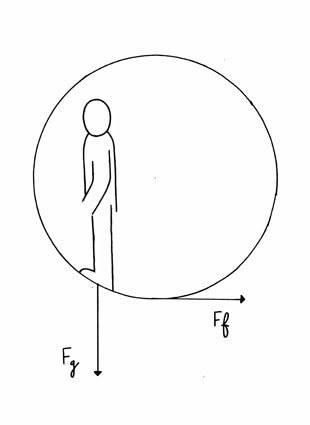

Free-body diagram of a person standing inside a large circular wheel at its lowest point, with a downward arrow labelled Fg for gravity and a rightward arrow labelled Ff for friction.
The two forces that I think decide whether the wheel is going to roll or not - rolling resistance and gravity on the person - seem to work in different directions?2)

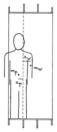

Line drawing of a tall cylindrical wheel with a person standing inside, labelled m_p and x_p for the person's mass and centre offset, and m_w and x_w for the wheel's mass and offset, with a dashed vertical centre line.
The wheel will lean to one side when the combined centre of mass of the wheel and the person in it is not positioned above the resting surface.
(mw.xw - mp.xp) / (mw + mp) = 0
This can be reduced to a function of a and b.3)

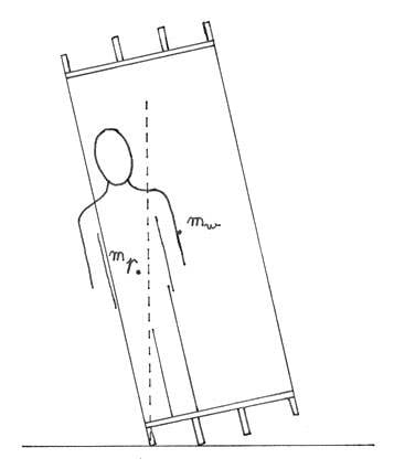

Side-view sketch of a person standing inside a tilted cylindrical wheel, with a dashed vertical centre line, labelled m_w for the wheel and m_p for the person, resting on a flat floor.
The wheel will not fall when the combined centre of mass is positioned above the resting surface.
But what is the influence of inertia - as a result of the leaning movement - on the position of the combined centre of mass?
All of these could result in a graph with a and b as axes from which I could deduct their ideal value.

If you want it leaning over like that, flare the outer rim out so that it'll be perpendicular to the ground at max cornering. Less chance of it toppling over.
The size of the rings can be found from trigonometry assuming you know the maximum lean angle for cornering. And the width should be as wide as feasably possible to help with stability. I'd make a stab at at least 1.1m wide.

Dansercoer: On level ground, I think the equation for diagram 1 (your second diagram) would be c > [2*mw*r*a + (mw + mp)*g*b]/(mp*g), where c = horizontal distance from centre of wheel to centroid of human, mw = wheel mass = 80 kg, mp = human mass, r = wheel radius = 1.100 m, a = wheel rectilinear acceleration, b = rolling resistance coefficient (in units of length), and g = 9.8067 m/s^2. I don't have suggestions for example values for b; you will need to research example values. If you want a certain value for a, such as a = 0.1 m/s^2, which means the wheel can start rolling, plug a = 0.1 m/s^2 into the above equation; then the equation says, if c is greater than the right-hand side, the wheel should start rolling (on level ground).

Several more parameters would need to be defined and shown on diagram 3 to develop an equation for that diagram, such as lean angle due to rib height difference, maximum variation in ground surface embedment, human centroid location coordinates, etc. As currently drawn in diagram 3, on a hard ground surface, by inspection, the wheel does not fall over, because both centroids are to the right-hand side of the dashed line.

Dansercoer: For diagram 3, you can ignore angular momentum. For diagram 1, I took summation of moments about the ground contact point, as follows. Summation(M) = 0 = mp*g*c - I*alpha - (mw + mp)*g*b, where I = wheel mass moment of inertia = Io + mw*r^2 = 2*mw*r^2, and alpha = wheel angular acceleration = a/r. Solve for c, then change the equal sign to a greater-than sign. You correctly spotted the rolling resistance force.

(3) I made the rolling resistance a vertically upward force acting at a horizontal distance b in front of the wheel centre ground contact point, which creates a clockwise moment in diagram 1. If you compute a horizontal force couple at the wheel centre and ground necessary to overcome this rolling resistance moment, then the force is F = [(mw + mp)*g*b]/r, pointing forward at the wheel centre, and backward at the ground.

I meant, I drew the rolling resistance force vector vertically upward, at the bottom of the wheel, at a horizontal distance b in front of the wheel centre ground contact point. Rolling resistance coefficient b would generally be much less than r.
Yes, overcoming the rolling resistance is the task of the person. And that's why this overcoming moment is not explicitly included in my moment summation equation. This overcoming moment is already included in m*g*c.
