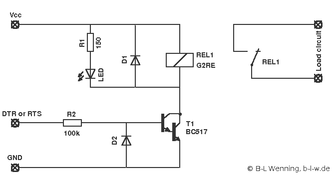

I've done this with one of the USB to serial conversion ICs (FTDI FT232BM). We used one of the flow control lines (RTS? CTS?) that was offered by the conversion chip, but wasn't being used for anything. Worked pretty well, actually (although it was only driving a very low-current miniature telecom relay).

There is plenty of microcontrollers that can handle usb, but they require more complicated programming.
As an alternate, you can get a cheap $3.49 USB to serial converter. All you have to do is devise a simple serial interface that turns on a relay. If you are using windows, you can send commands to the serial through the hyper terminal in the accessories menu, or code a simple app in C or C++ or any language of choice to send data to the serial port.
Here is the converter:
http://cgi.ebay.com/USB-to-Serial-Cable-RS232-DB9-Magellan-Garmin-PC-new_W0QQitemZ230377060753QQcmdZViewItemQQptZLH_DefaultDomain_0?hash=item35a38af991
And the schematic prototype: this whole thing should cost you less that $5 bucks
