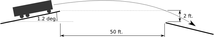

I calculated this last night during the show, I wasn't going to post it right away, but why not ;-)
The bus takes off, with velocity [itex]v[/itex], from a launch ramp inclined at an angle [itex]\theta[/itex] above the horizontal. That means the horizontal and vertical components of its initial velocity are [itex]v \cos\theta[/itex] and [itex]v\sin\theta[/itex] respectively. Also, let's designate the height of the cusp of the landing "platform" as [itex]y = 0[/itex], so the edge of the ramp is at some height [itex]y_0[/itex] (+2 feet in the movie, according to Mythbusters); and let [itex]x=0[/itex] be the horizontal position of the edge of the ramp.
The equations for motion accelerated by gravity (without air resistance) are
[tex]x = v_x t[/tex]
[tex]y = y_0 + v_y t - \frac{1}{2}g t^2[/tex]
Putting them together gives
[tex]y = y_0 + \frac{v_y}{v_x}x - \frac{1}{2}g \biggl(\frac{x}{v_x}\biggr)^2[/tex]
and substituting in for the velocities gives
[tex]y - y_0 = x \tan\theta - \frac{1}{2}g \biggl(\frac{x}{v}\biggr)^2\sec^2\theta[/tex]
If we were to scale down [itex]y - y_0[/itex], [itex]x[/itex], [itex]g[/itex], and [itex]v[/itex] by 12, the ratio [itex]x/v[/itex] would remain the same and the factor of 1/12 in everything else would cancel out. So a perfect 1/12 scale model with 1/12 gravity should work. But if you can't change gravity, you need to change [itex]v[/itex] to compensate for scaling down [itex]y - y_0[/itex] and [itex]x[/itex]. Increasing [itex]v[/itex] by [itex]\sqrt{12}[/itex] seems like it should do the trick.
I plugged some numbers in using Mathematica and calculated that the real bus would need a velocity of 78 mph to clear the jump, and a 1/12 scale model bus (with full-scale gravity) would need 22.6mph to clear a 1/12 scale model jump. (I guess that assumes the bus is a point particle, but whatever) I would have thought those numbers should be higher :-/ I suspect air resistance.
P.S. if we neglect the 2-foot elevation, [itex]y - y_0 = 0[/itex] at the landing point, so
[tex]x \tan\theta = \frac{g}{2} \biggl(\frac{x}{v}\biggr)^2\sec^2\theta[/tex]
or
[tex]\sin\theta\cos\theta = \frac{g}{2} \frac{x}{v^2}[/tex]
or
[tex]v = \sqrt{\frac{xg}{\sin 2\theta}}[/tex]
as described on the website.
Could you list the exact launch angle, vertical drop, and range used to find these velocities? I'll compare to the Hyperphysics website calculator and my own code model in Numerit Pro.
launch angle:
[itex]\theta = 1.2^{\circ}[/itex] in both cases
vertical drop:
[itex]y_0 = 2\,\mathrm{ft.}[/itex] for the bus in the movie
[itex]y_0 = \frac{2}{12}\,\mathrm{ft.}[/itex] for the model bus
range:
[itex]x = 50\,\mathrm{ft.}[/itex] for the bus in the movie
[itex]x = \frac{50}{12}\,\mathrm{ft.}[/itex] for the model bus
What didn't you follow in the substitution? I thought it would be pretty easy...
P.S. Just realized, those numbers came from my calculator, not Mathematica. Mathematica's handling of units is pretty terrible.

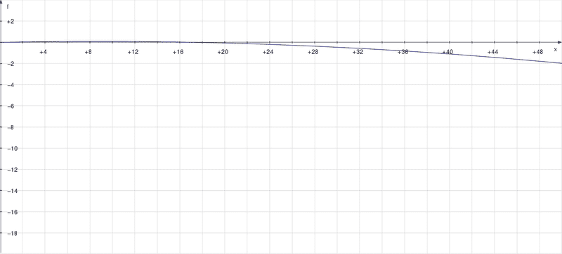

Thanks. I'll use those numbers to build a digital simulator and post a graph of the result here.

I'm planning to write up something on the effect of air resistance on this experiment - I probably would have done it today if I had time. The Mythbusters do a lot of stuff where air resistance is a factor so I'm getting used to it ;-) but that NASA link looks interesting, thanks.
One interesting detail of scale down studies is the ratio of mass to aerodynamic surface area makes the small scale object much more sensitive to air drag, lift, etc.

In the movie, according to the Mythbusters, the givens are as follows (thanks to diazona):
Constant in Both Cases:
[itex]\theta = 1.2[/itex] degrees launch angle
g = 32.174{ft/s/s/} standard acceleration of gravity
Movie Bus Jump:
R = 50{ft} horizontal range between launch and landing ramp
y0 = 2{ft} elevation of launch ramp above landing ramp
Model Bus Jump:
R = 50/12{ft} horizontal range between launch and landing ramp
y0 = 2/12{ft} elevation of launch ramp above landing ramp
Neglecting air resistance, bus angular rotation, bus length, etc. the initial velocity to make the jump is given by:
[tex]v_{0} = \frac{R}{\sqrt{\frac{2(R tan \theta +y_{0})}{g sec^{2} \theta}}}[/tex]
where gravity g and angle theta are the same in both calculations and we're getting the same numbers as the Mythbusters mention in the episode.
This equation gives v0 in feet per second with the above units. Multiply by 0.68 to get mile per hour. It is not clear yet why the model bus misses the jump in the episode ...
