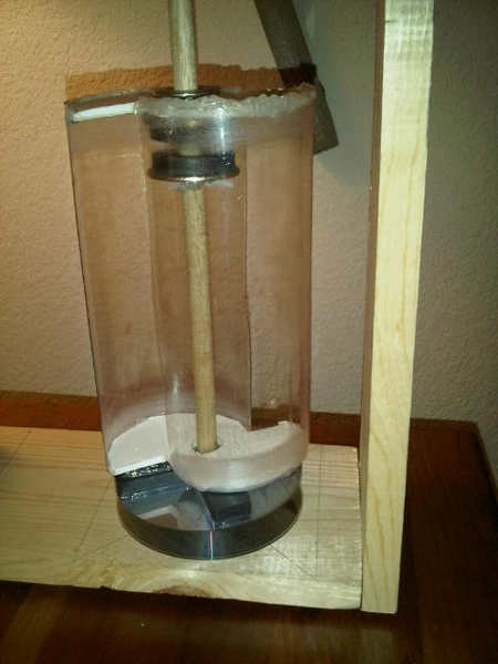

Here is the turbine:
We used CDs instead of cardboard for the stator and rotor.

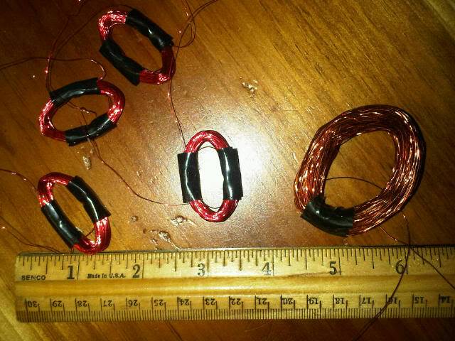

Here are the coils, the small ones were 190 turns of 30 gauge (AWG) magnet wire:
The large one is 300 turns of 27 gauge. This is what I have now.

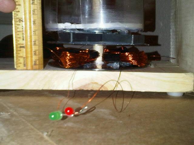

Here is a shot showing the gap between the coil and the magnet. Looks like it is about 1 millimeter, like the directions recommend.

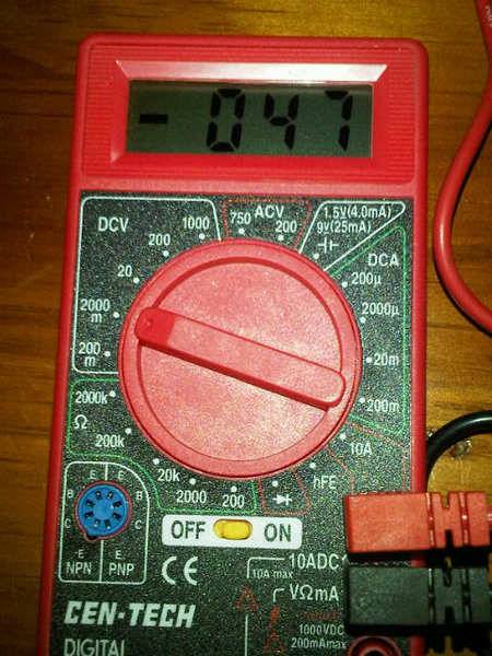

Here is a voltmeter reading.
I'm not an expert at reading these, but I think this means -0.047 volts DC.
The readings jump around a lot while you spin the turbine, but this is a typical reading.
I've bought an analog meter, but I haven't tried it yet.
The analog meter also gives very low or zero readings.
My electronics is a little fuzzy but I believe you voltmeter is reading 47 millivolts. Reverse your probes and the voltage should read positive. The dial is turned to 2000 millivolt range meaning it will read UP TO 2000 millivolts or 2 volts max.
RTW69,
Thanks for the advice. That makes sense. That is a better explanation than I found in the mulimeter's instructions.

first the magnets are to far apart
the meter on the 200 no 2000
and turn the wires of the meter ,that way you don't have _

1. multimeter is on dc and should be on ac. if is not link after LED.
2. you magnets are to far and are ceramic 5 time weaker than neodymium.
3. your result is nicer and better than what you try to build.
I think dinablaster makes a good point.
The generator is really an alternator, so using the meter on its DC range gives a meaningless reading. Switching it to AC probably won't improve things, the frequency is probably too low for the innards of an ordinary AC meter.
