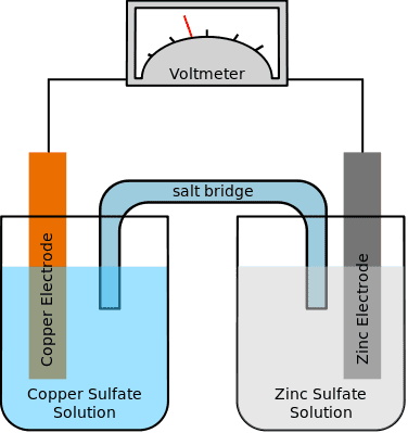

You are talking about this arrangement, seen in Chemistry classes:
Normal batteries are not like that, but imagine you had two of these and connected them in series. Can you see that the voltage would be doubled if you measure the combination?

This is exactly like the image I was looking at when I read about the Galvanic cell. I can imagine adding two more electrodes in the system and connecting the four electrodes to the voltmeter. This should increase voltage, no?
Yes, that is right. To connect the cells in series, you have to join a positive and a negative terminal together (but not from the same cell) and then take the output from the other terminals.
Yes, that is right. To connect the cells in series, you have to join a positive and a negative terminal together (but not from the same cell) and then take the output from the other terminals.OK. So therefore, the cathodes and anodes in each battery do exchange electrons inside the battery and not just across the wire. Is this what you, guys, mean?
No. The electrons are generated by taking them from the zinc atoms and allowing them to flow in the outside circuit to the copper ions in solution which then become copper atoms on rhe copper electrode. They don't flow inside the cell.
OK. I think I am starting to understand the terms a little better but I still can't see the logic. Here is a simplified diagram I made of two batteries connected in series. If, like you wrote, there is no flow of electrons inside the batteries, the road is basically blocked for the middle two cells to power the circuit with the voltmeter.
Again, why would voltage increase? :(
Let's try from the beginning. If you have 4 1.5 volt batteries in contact end-to-end, you have a potential of 6V across whatever circuit you try to power with that bank of batteries. What is the potential at the negative end of the first battery and at the positive end of the last battery? That difference is the amount of voltage potential available to the circuit.

In this circuit, the electrons become permanently attached to copper ions to become copper metal.
Cu 2+ + 2e → Cu
This is a necessary concept or else you would have electrons flowing from positive to negative inside the battery.
Electrons are generated at the negative terminal by the reaction of Zinc metal becoming Zinc ions:
Zn → Zn 2+ + 2e
It is the Chemistry of the battery internals that drives the production of an EMF at the battery terminals.
The effect is that electrons come out of one terminal and go back into another terminal, but the point is that they are not the same electrons.

Electrons travel, on average, at about 1mm/s. The electron that latches onto a metal ion may well never get to the other side of the cell but another electron will be pushed off at the other terminal. Don't you SEE why you are really going about this the hard way?
Surely you have looked at one or two of the million you tube movies that explain how a Daniel Cell works. If you haven't, then I recommend that you do. The end of that is that a magical 1.5 volts appears across the terminals. Just accept that nothing later on in the chain of processes is affected by how this 1.5V is produced - it could be from a transformer and rectifier or a DC dynamo.
Although forces are involved between the electrons in a piece of wire and forces make them move, ultimately, those forces are only the same as the forces between the links of a bicycle chain. As with the bicycle, what counts is the energy put in and how that energy is transferred at the other end. Two people on a tandem can produce twice as much energy for one turn of the pedals. Two batteries in series can produce twice as much energy for every coulomb that passes through them.
Just treat Charge as Charge - how it is carried is quite irrelevant to this part of the argument. It can be the (-) charge on a moving electron or the (+) charge on a positive Ion in the cell. We just use Charge and it flows in the conventional current direction. Don't fight it. Use it and believe that, in the end, you will link it all together in your brain and you will say "no problem - I've got it now". But if you battle against doing it 'our way' you may never get there.
