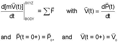

The form of Newton's Laws of Motion selected for this writing is arranged in accord with Newton's axiomatic approach. Calculus is made explicit; the derivative of body momentum is placed prominently, left of equality. Subscripts of the derivative to identify the system (body for now). Superscripts to the derivative to identify the vector space. Finally ΣF replaces F right of equality in s differential equation, where non-homogeneous terms belongs. Vectors... all properly notated. Phew! Also we need the initial conditions written near the differential equation.
Mathematical notation says this better than words.
Equation (8): d[mV(t)]/dt (BODY, 0XYZ) = ΣF, with V(t) ≡ dP(t)/dt, and P(t = 0+) = P_0+ and V(t = 0+) = V_0
(8)8

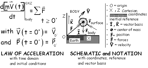

In use, Newton's equation is accompanied by a sketch of the physical situation. The sketch below is over- complete. In any application such completeness is rarely needed. However the sketch puts a picture to all of the ideas brought together.
Left, the Law of Acceleration with time domain and initial conditions: d[mV(t)]/dt = ΣF for t ≥ 0+, with V(t = 0+) = V_0 and P(t = 0+) = P_0. Right, schematic and notation: a BODY above Earth in X–Z Cartesian coordinates with origin 0, vector basis I, K, center of mass, position P, forces F_surface and F_body, and velocity V.
