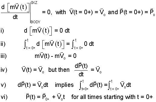

The next classical solution in this vein is that of a body with constant momentum but non-zero initial velocity. Space and all are defined as before. The differential equation is:
Equation (17): d[mV(t)]/dt (BODY, 0XZ) = 0, with V(t = 0+) = V_0 and P(t = 0+) = P_0
(17)17
Can you solve the above differential equation? Give it a try! The solution is:
Pbody(t) = Pbody,0+ + Vbody,0+ t for all times, t > 0+
It is likely that you've seen this solution in physics but different. To obtain the high school physics form, first rearrange the solution to have the form, P(t) - P0+ = V0+t. Next ignore the obvious idea "where it started" and set P0+ to zero, to have: P(t) = V0+t.. Next to avoid vectors change P(t) to S and V0+ to V, both scalars. That is pretty much the way the meaning and diversity of Newton's understanding of uniform is smoked and canned for use in high school physics: S = Vt. Our next example, Yacht and Sea Buoy, illustrates (at a beginning level) uniform motion in which two-dimensional-relative motion is considered.
• Constant Momentum, Non-Zero Velocity Motion Steps of the integration: Newton's First Law of Motion applies to bodies with constant momentum. His differential equation states that momentum (in 0XZ-space) is constant as long as the sum of forces equals zero ( ΣF = 0):
Equation (18): d[mV(t)]/dt (BODY, 0XZ) = 0, with V(t = 0+) = V_0 and P(t = 0+) = P_0
(18)18
Newton's equation applies for times during which the body is observed. Specific epochs begin at the time, t = 0+, the instant observation commences. The above mathematical statement is inspecific; by itself it has no solution. To obtain a solution an "initial condition," the momentum of the body at the beginning (at t = 0+), is needed. Two cases for constant momentum of the mass are zero velocity and constant, non-zero velocity. The zero-velocity case was solved above. The solution for the second case proceeds as follows.
Equation (19): d[mV(t)]/dt (BODY, 0XZ) = 0, with V(t = 0+) = V_0 and P(t = 0+) = P_0. i) d[mV(t)] = 0 dt; ii) ∫ from t = 0+ to t of d[mV(t)] = ∫ from t = 0+ to t of 0 dt; iii) mV(t) − mV_0 = 0; iv) V(t) = V_0, but then dP(t)/dt = V_0; v) dP(t) = V_0 dt implies ∫ from t = 0+ to t of dP(t) = ∫ from t = 0+ to t of V_0 dt; vi) P(t) = P_0+ + V_0 t for all times starting with t = 0+
(19)19
