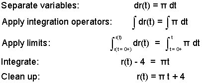

Equation with initial condition:
dr(t)/dt = π and r(t) at t = 0+ = 4
We need to be able to solve the above type equation. All others in thermo and fluids are much the same except for other notations for terms. The steps below are the same ALWAYS."
Separate variables: dr(t) = π dt. Apply integration operators: ∫dr(t) = ∫π dt. Apply limits: ∫ from r(t = 0+) to r(t) of dr(t) = ∫ from t = 0+ to t of π dt. Integrate: r(t) − 4 = πt. Clean up: r(t) = πt + 4
Above we see the differential equation and the steps to obtain its solution subject to the prescribed initial condition.

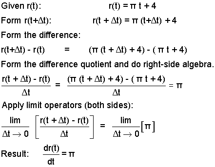

"Tell me," you might be asked. "Given this solution (the one above) what differential equation belongs to it?
So you go at the solution as below and create the differential equation it belongs to ~ as shown.
Given r(t): r(t) = πt + 4. Form r(t + Δt): r(t + Δt) = π(t + Δt) + 4. Form the difference: r(t + Δt) − r(t) = (π(t + Δt) + 4) − (πt + 4). Form the difference quotient and do right-side algebra: [r(t + Δt) − r(t)]/Δt = [(π(t + Δt) + 4) − (πt + 4)]/Δt = π. Apply limit operators (both sides): lim (Δt → 0) [r(t + Δt) − r(t)]/Δt = lim (Δt → 0) [π]. Result: dr(t)/dt = π
